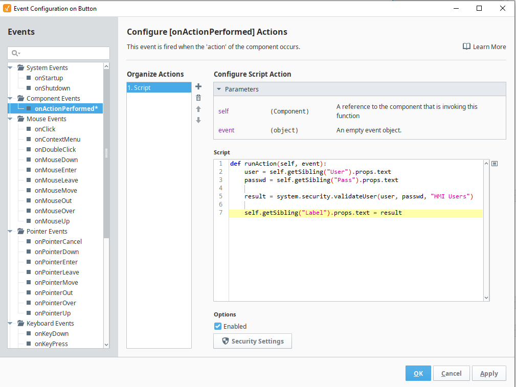

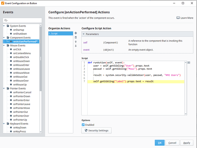

**Author:** ![Felipe\_CRM](https://avatars.discourse-cdn.com/v4/letter/f/dfb087/32.png) [@Felipe\_CRM](https://forum.inductiveautomation.com/u/Felipe_CRM)\
**Post date:** [December 8, 2023, 5:59pm UTC](https://forum.inductiveautomation.com/t/perspective-support-team-login-to-same-session/82905/12 "2023-12-08T17:59:51Z")
The docs might need to be updated if that's the case:
 ![image](https://us1.discourse-cdn.com/inductiveautomation/original/3X/0/9/09935b0b00f678e7f89be797ba9a88fb86fcc94f.png)
I was about to test it out to see if it would actually work, so I'll provide an update shortly.
EDIT: set up a quick test and it at least appears to work:
 ![image](https://us1.discourse-cdn.com/inductiveautomation/original/3X/5/c/5ce142fc87acfcb9c6678ab59dae5ddcff8c0339.png)
(Please excuse the ugliness of my test setup):
 ![image](https://us1.discourse-cdn.com/inductiveautomation/original/3X/3/a/3a404dfe24f14bdd157d751971c447ef471df7e0.png)
This was tested on 8.1.27.
**Author:** ![Eagel007](https://avatars.discourse-cdn.com/v4/letter/e/7bcc69/32.png) [@Eagel007](https://forum.inductiveautomation.com/u/Eagel007)\
**Post date:** [December 8, 2023, 6:16pm UTC](https://forum.inductiveautomation.com/t/perspective-support-team-login-to-same-session/82905/13 "2023-12-08T18:16:45Z")
nice! so I can record their username then to a custom property.
and set to null if they decided to log out! thanks
**Post date:** [December 8, 2023, 6:20pm UTC](https://forum.inductiveautomation.com/t/perspective-support-team-login-to-same-session/82905/14 "2023-12-08T18:20:51Z")
Keep in mind that you have to put in a user source for the third argument, an Identity Provider won't work (as Paul stated).
