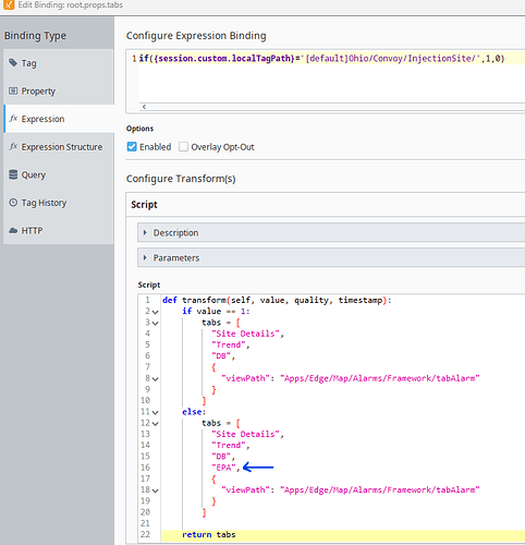

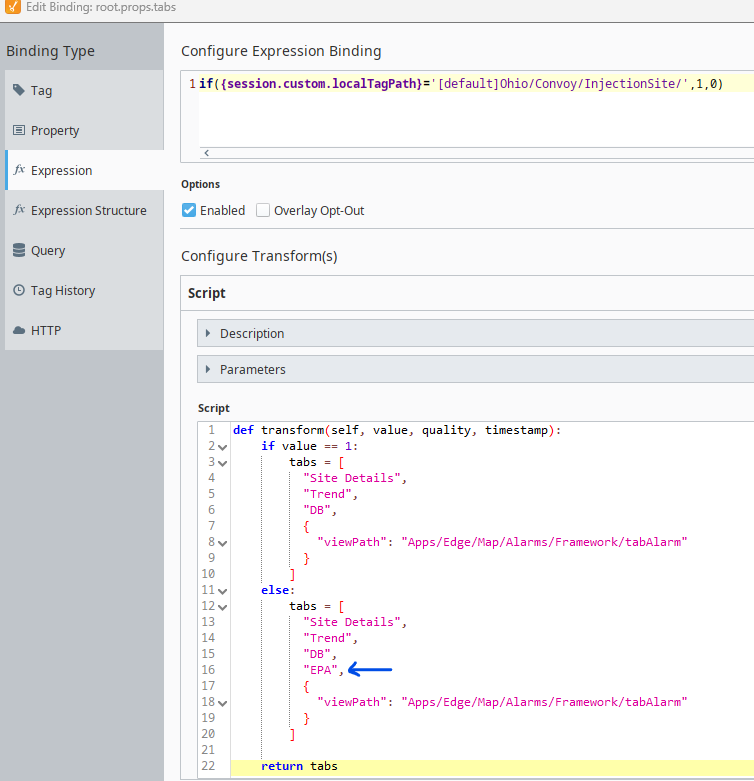

**Post date:** [July 10, 2025, 2:12pm UTC](https://forum.inductiveautomation.com/t/perspective-tab-container-security/32739/9 "2025-07-10T14:12:06Z")
Bump. Solved this using expressions. Didn't see a solution shared.
EPA tab is the one I hide or show.
Script to change tabs.
 ![image](https://us1.discourse-cdn.com/inductiveautomation/original/3X/4/2/422fc4691937ee8dd3190a0f89301c836a548a92.png)
 ![image](https://us1.discourse-cdn.com/inductiveautomation/original/3X/4/1/4167abe0f1817655d2e2224e17e5028add1441f0.png)
Script to change tabIndex. One to remove tab and one to change index number.
Script on EPA Tab view. Tab to hide. To hide, I used -1.

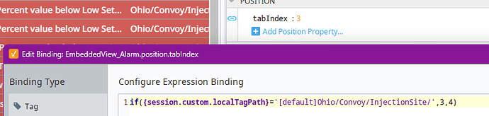

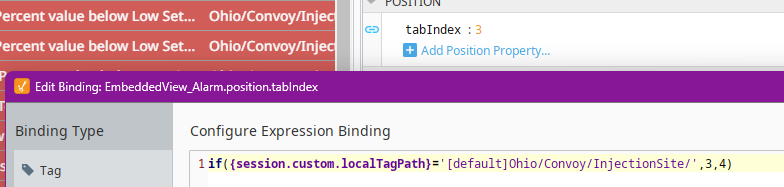

 ![image](https://us1.discourse-cdn.com/inductiveautomation/original/3X/7/1/7140a1131be17828c62772d67c81ea32f8b9b72b.png)
Script on Alarm Tab view. Tab to shift. When the 3rd tab is removed, the 4th tab is changed to the 3rd tab.
 ![image](https://us1.discourse-cdn.com/inductiveautomation/original/3X/3/d/3dfdb28a1eb612337e95bcc606401a990436f887.png)

**Author:** ![stevenson](https://avatars.discourse-cdn.com/v4/letter/s/41988e/32.png) [@stevenson](https://forum.inductiveautomation.com/u/stevenson)\
**Post date:** [July 10, 2025, 5:54pm UTC](https://forum.inductiveautomation.com/t/perspective-tab-container-security/32739/10 "2025-07-10T17:54:02Z")
I think this solution only works if you're hiding the last item in the tabs array.
If you re-arrange your list so that EPA is in front of DB, then switching to DB will open the EPA container view.
I ended up rolling my own with a tab strip using flex repeater for tabs and various message handlers to change the embedded view path.
**Author:** ![tebright1](https://sea1.discourse-cdn.com/inductiveautomation/user_avatar/forum.inductiveautomation.com/tebright1/32/87405_2.png) [@tebright1](https://forum.inductiveautomation.com/u/tebright1)\
**Post date:** [July 11, 2025, 9:34pm UTC](https://forum.inductiveautomation.com/t/perspective-tab-container-security/32739/11 "2025-07-11T21:34:31Z")
The last tab Alarms also has a script to change the tab number. From 4 to 3. I used scripts to change the tab embedded views to match the active tab position. Worked for me.
