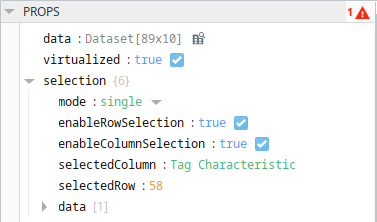

**Author:** ![nickbartsch](https://avatars.discourse-cdn.com/v4/letter/n/cab0a1/32.png) [@nickbartsch](https://forum.inductiveautomation.com/u/nickbartsch)\
**Post date:** [June 12, 2020, 10:30pm UTC](https://forum.inductiveautomation.com/t/perspective-table-cell-binding-to-tag/35609/3 "2020-06-12T22:30:08Z")
Sorry, I wasn’t very clear in my original post. The data for my table is from a dataset so I can’t seem to access an individual cell to provide the tag binding for. Is it still possible to provide a tag binding for an individual cell when using a dataset?
![dataset](https://us1.discourse-cdn.com/inductiveautomation/original/2X/2/22e4d5920a195e0b6f8164405a1bcd2b847ec1d4.png)
**Post date:** [June 12, 2020, 10:59pm UTC](https://forum.inductiveautomation.com/t/perspective-table-cell-binding-to-tag/35609/4 "2020-06-12T22:59:33Z")
No. You can either use a transform on whatever operation is bringing in the dataset, or bring in your data in a JSON format in the first place.
**Post date:** [June 15, 2020, 12:37pm UTC](https://forum.inductiveautomation.com/t/perspective-table-cell-binding-to-tag/35609/5 "2020-06-15T12:37:38Z")
That’s what I figured, thanks for your help!

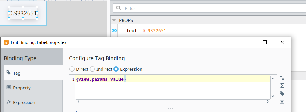

**Author:** ![phandc](https://avatars.discourse-cdn.com/v4/letter/p/ce73a5/32.png) [@phandc](https://forum.inductiveautomation.com/u/phandc)\
**Post date:** [November 10, 2021, 6:01pm UTC](https://forum.inductiveautomation.com/t/perspective-table-cell-binding-to-tag/35609/6 "2021-11-10T18:01:28Z")
@paul-griffith , @nickbartsch I also want to bind some table cells in a row to some tags. Therefore, I have embedded a view for each cell in table column mode. In each view, I have a label binding to a value parameter that represents a tag path. You can see it in the figure below.
 ![image](https://us1.discourse-cdn.com/inductiveautomation/original/3X/6/2/6268e128356fbf21444edc28510bd495527c7928.png)
It worked in my case. However, when the number of cells increases, I have to make the same number of views with the same logic. Is there any way better than that?
Thank you for your time!
