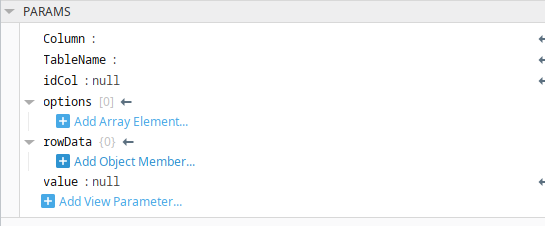

The Params on my dropDownView
 ![image](https://us1.discourse-cdn.com/inductiveautomation/original/2X/2/2dce23d5bb7c63aa062eed7e16de329bcb768d51.png)
Because I’m going to update a database all my params are set to input, you can tell by the arrows, but depending on what you want to do you might want to change that.
I bind the `options` prop to the options param I gave the view, then there is one script on the dropdown itself.

my post was probably not extremely clear but alarms are not the problem and I posted here because I’m using exactly what was suggested before: I am basically editing a table on double click of a cell and this cell is a dropdown view which must on selection return an event to the table view to tell it to update the cell with the dropdown selection.
The table represents fields of a list of alarms which I edit just as you said using system.tag.getConfiguration() and then writing with system.tag.configure() however the problem is the bidirectional binding of a variable which is not returned, what I currently have is a binding as below of the column viewParams:
 ![image](https://us1.discourse-cdn.com/inductiveautomation/original/3X/c/9/c9c9b8d54083ef883767f500c965d56d76696da6.png)
the dropdown has a onActionPerformed event to set the bidirectional variable:
 ![image](https://us1.discourse-cdn.com/inductiveautomation/original/3X/8/b/8b0ff82b7b99c0c9348217d1a7df92b709831522.png)
and here are all the params including the changed\_value (notice I tried with rowData as bidirectional as well as other direction combinations but nothing ever worked)
![image](https://us1.discourse-cdn.com/inductiveautomation/original/3X/d/4/d480e37b961c6ff8f7eef1f05efe421826e30f53.png)
hope this clears it up, basically I’m doing what @RadicalRumin suggested I think.
