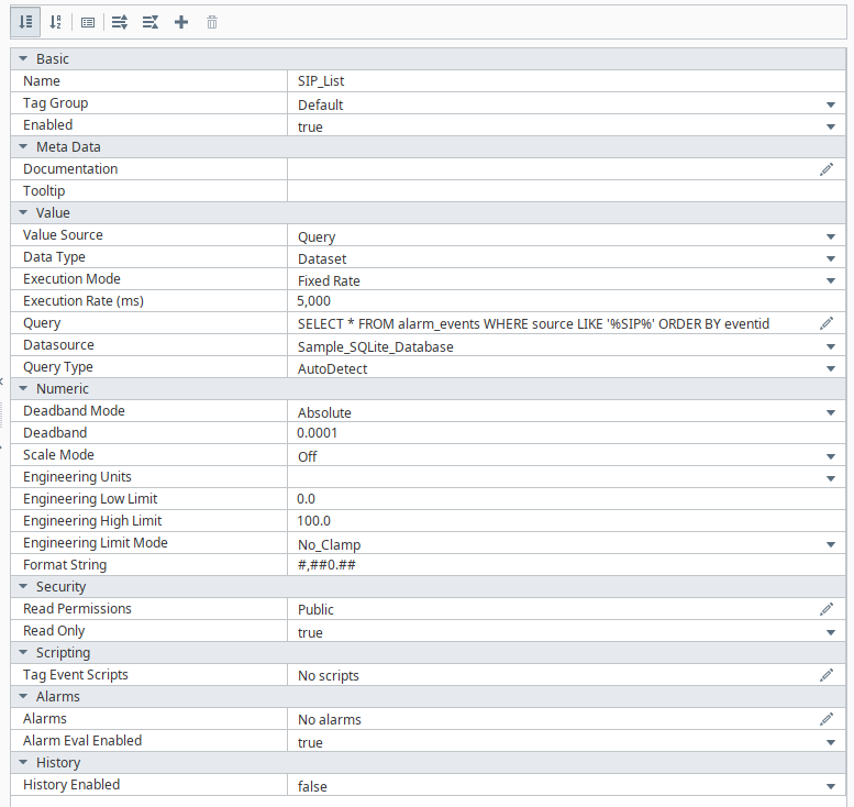

I am new here, I am having problems with the display of Date Type data in the perspective tables, the rendering does not work for me. Does anyone have an idea what I'm doing wrong?
I am reading the data from the alarm database and displaying it in a table... attached image.

Where does the data come from ?
This looks like alarm events, are you using the `system.alarm.*` functions ?
**Author:** ![AAC](https://avatars.discourse-cdn.com/v4/letter/a/a6a055/32.png) [@AAC](https://forum.inductiveautomation.com/u/AAC)\
**Post date:** [April 12, 2024, 9:46am UTC](https://forum.inductiveautomation.com/t/perspective-table-not-rendering-datetime-data/88731/3 "2024-04-12T09:46:24Z")
Nop, database query tag... from DB Alarms
 ![Screenshot 2024-04-12 114509](https://us1.discourse-cdn.com/inductiveautomation/original/3X/e/8/e84cabc1e4bcb41d8ea446ef9fff7b3ce59e3a66.png)
**Post date:** [April 12, 2024, 11:42am UTC](https://forum.inductiveautomation.com/t/perspective-table-not-rendering-datetime-data/88731/4 "2024-04-12T11:42:26Z")
If you go back to the Dataset Editor and use the _Copy to clipboard_ button, what is the type of the eventtime column? It needs to be **L** (long) and not **str**.

Actually, I've just remembered, you can check the datatype by clicking a cell in the Dataset editor.
Brain slow today: Notice that Dataset Editor is showing all the numeric columns right-justified but eventtime is left justified. I think it's a string.
**Post date:** [April 12, 2024, 12:22pm UTC](https://forum.inductiveautomation.com/t/perspective-table-not-rendering-datetime-data/88731/5 "2024-04-12T12:22:18Z")
String for sure.... issue solved using 'fromMillis' after casting to Int, now works.
