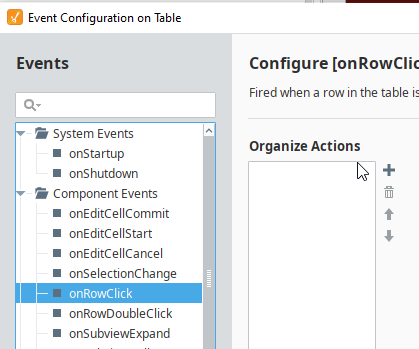

**Post date:** [April 14, 2023, 3:08am UTC](https://forum.inductiveautomation.com/t/perspective-table-question/72441/2 "2023-04-14T03:08:54Z")
You can use the onRowClick event handler to do this:
 ![image](https://us1.discourse-cdn.com/inductiveautomation/original/3X/e/9/e988c4b8dd1f4f2af239b5cf98162b86693a29d3.png)
(Right click on the table and click on "Configure Events...")

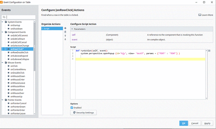

**Author:** ![jiyoung\_hwang1](https://avatars.discourse-cdn.com/v4/letter/j/bc79bd/32.png) [@jiyoung\_hwang1](https://forum.inductiveautomation.com/u/jiyoung_hwang1)\
**Post date:** [April 14, 2023, 4:41am UTC](https://forum.inductiveautomation.com/t/perspective-table-question/72441/5 "2023-04-14T04:41:12Z")
For example, when pressing United States, 'params = text' is entered and
What should I do to make it enter 'params = hello' when I press Finland?
 ![1](https://us1.discourse-cdn.com/inductiveautomation/original/3X/f/8/f8a000781ea16dc4903b707a8263c6be112a61c5.gif)
**Post date:** [April 14, 2023, 6:02am UTC](https://forum.inductiveautomation.com/t/perspective-table-question/72441/6 "2023-04-14T06:02:23Z")
```auto
country = event.value.country
system.perspective.openPopup(id='bob', view='test7', params={'TEXT': country})
If you really wanted "hello" if Finland, then:
```auto
if country == 'Finland':
	country = 'hello'

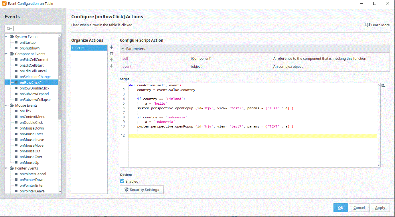

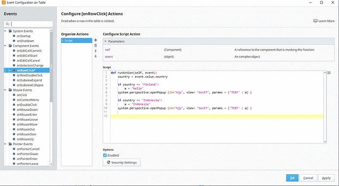

**Post date:** [April 17, 2023, 12:30am UTC](https://forum.inductiveautomation.com/t/perspective-table-question/72441/9 "2023-04-17T00:30:08Z")
When I selected Finland, the pop-up worked fine.
No pop-up window appeared when pressing Indonesia
What should I do?
 ![2](https://us1.discourse-cdn.com/inductiveautomation/original/3X/5/7/5706655f3cc25f0265969d4932800a09b822c5e2.gif)
**Post date:** [April 17, 2023, 12:42am UTC](https://forum.inductiveautomation.com/t/perspective-table-question/72441/10 "2023-04-17T00:42:39Z")
if `country != 'Finland'`, then `a` doesn't exist and the code is halting.
Try this instead:
```auto
	a = 'hello'
elif country == 'Indonesia':
	a = 'Indonesia'
else:
	a = 'something else'
system.perspective.openPopup....
ps. it's best to avoid calling the same function for different cases; it's better to call it once after setting up the variables passed as the args of the function inside the case (ifs) statements.

**Author:** ![justinedwards.jle](https://sea1.discourse-cdn.com/inductiveautomation/user_avatar/forum.inductiveautomation.com/justinedwards.jle/32/37854_2.png) [@justinedwards.jle](https://forum.inductiveautomation.com/u/justinedwards.jle)\
**Post date:** [April 17, 2023, 12:50am UTC](https://forum.inductiveautomation.com/t/perspective-table-question/72441/11 "2023-04-17T00:50:03Z")
The code has to be structured in a way where all referenced variables have an assigned value.
**Example:**
```auto
#def runAction(self, event):
		a = 'hello'
		a = 'Indonesia'
	else:
		a = 'None'
	#system.perspective.openPopup(id...
Note how the variable is assigned a value no matter what country equals.
