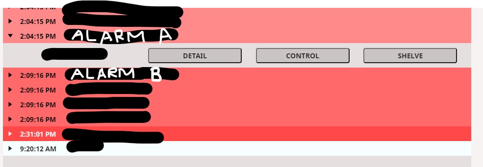

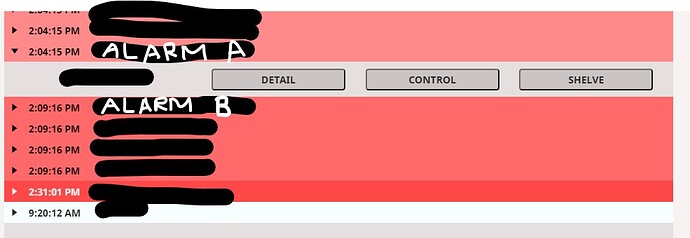

Version: **8.0.16 (b2020082513)**
I have a perspective table with a subview. The table shows alarms and on the subview there is an option to shelve the alarm. This causes the row to disappear because the table only shows unshelved alarms.
When the row disappears, a subview stays open and because the row it was open on is gone, the new row that has taken its place has the subview open.
 ![before](https://us1.discourse-cdn.com/inductiveautomation/original/3X/2/e/2e40e75f40abc61efe86d05f2a07ad3f77bffaf5.jpeg)
In the above image I shelve ALARM A and the row for ALARM A will disappear.

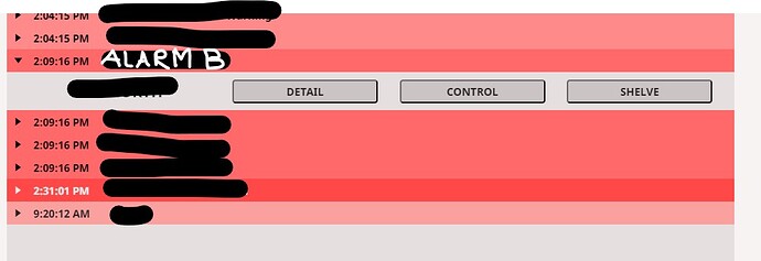

 ![after](https://us1.discourse-cdn.com/inductiveautomation/original/3X/4/b/4b9156072dc62e04e26586b2ccf7f2b80b7b4d47.jpeg)
In the above image, the subview stays open on ALARM B because ALARM B took ALARM A’s place.
I want the subview to close once the row disappears.

This isn’t a bug or an “unintended” feature - it is an _intended_ feature.
Think about it this way: A table’s data usually comes from a binding, and that binding is usually polling some underlying data source. Imagine how frustrating it would be if you expanded a row, only to have it collapse on you every time your data was updated!
The issue here is that the table’s understanding of the data’s meaning is too primitive. All it knows is that “Row X was expanded, so keep it expanded” without any understanding of the idea that the data that used to be on row X has moved to row Y or has been removed altogether. I think the only way for us to support a smarter version of this would be to have some kind of optional designation of a column as the “key column”. Right now, the row’s index is the implicit “key” of the row. But if you could specify your own data key, then the table would understand that it isn’t “Row X” that is expanded, but rather, “The row with this data key” where that key is a timestamp or a unique number or something.
Also, FYI, we’re adding scripting functions to programmatically expand and collapse rows, so at least in the meantime you’ll be able to control this function yourself.
