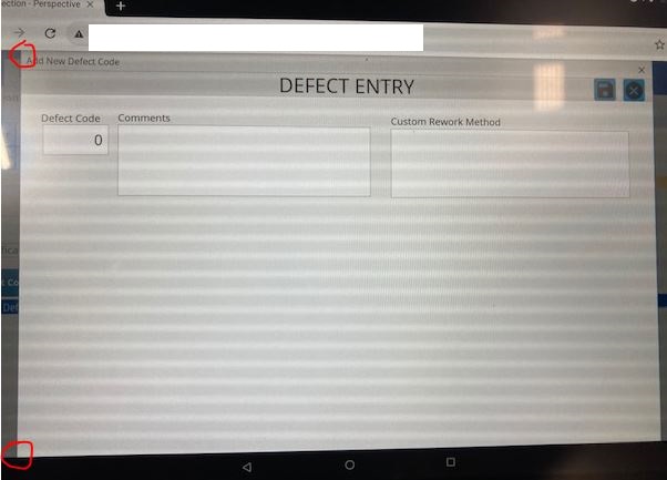

Hello,
I have a perspective application opening a popup to enter quality information (numeric and text fields).
The numeric and text fields do open the Android Onscreen Keyboard to enter values when the project is run from the “Perspective” android application.
When it is open from the android Chrome Browser on the same device, the onscreen keyboard does not show for that same project/screen.
I would expect the browser to work since it is running on a touchscreen tablet and any other website does show the keyboard.
Anybody get the same issue ? and a solution to fix it ?
**Author:** ![francois.morin](https://sea1.discourse-cdn.com/inductiveautomation/user_avatar/forum.inductiveautomation.com/francois.morin/32/15064_2.png) [@francois.morin](https://forum.inductiveautomation.com/u/francois.morin)\
**Post date:** [October 2, 2020, 2:50pm UTC](https://forum.inductiveautomation.com/t/perspective-tablet-keyboard-is-not-showing-when-used-from-a-web-browser/39308/2 "2020-10-02T14:50:34Z")
I found the issue.
When the popup resolution is bigger than the available size in the browser, The keyboard does not pop.
Since the popup view was designed to work in “Perspective” mobile application it was too big for the browser.
 ![Issue with inspection screen](https://us1.discourse-cdn.com/inductiveautomation/original/3X/1/0/103e07a11cfa52498c646e412fddb1b54d4591de.jpeg)

**Post date:** [October 2, 2020, 4:00pm UTC](https://forum.inductiveautomation.com/t/perspective-tablet-keyboard-is-not-showing-when-used-from-a-web-browser/39308/3 "2020-10-02T16:00:30Z")
