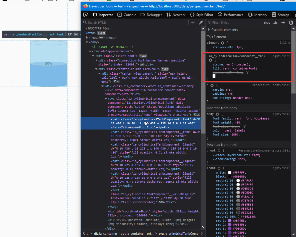

I want to change the color of a Tank - not the interior liquid color, but the Tank itself. Is there a property for this?
**Post date:** [November 21, 2020, 12:43am UTC](https://forum.inductiveautomation.com/t/perspective-tank-color/40857/2 "2020-11-21T00:43:32Z")
It doesn’t look like there’s any exposed property (currently). You’d have to dive into theming (I’d suggest doing a search on the forums, there’s some good introductory material by @cmallonee).
You’ll need to either provide a custom style for the cylindrical tank component in particular, or a different named `border` color:
 ![image](https://us1.discourse-cdn.com/inductiveautomation/original/3X/a/1/a1d5195e670865be5d8f54b28f8a89fffa362f03.png)
Note that this change would be global to _all_ cylindrical tanks - a `stroke` provided to an individual component doesn’t override the globally defined color. That’s probably something we can/will fix.
