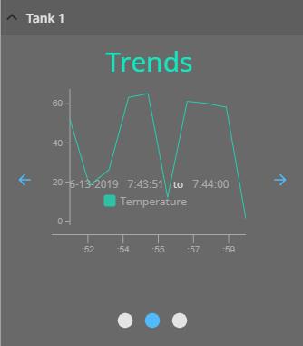

Added a time series graph and configured the animation to be on. Modified trends and axis to decrease the space between edge of component and y axis. How ever , while the component sits on a Carousel , transitioning to the pane containing said component displays time range and legend in the middle of the graph.
![imgo](https://us1.discourse-cdn.com/inductiveautomation/original/3X/f/6/f6e30c593494f4a652130bdaac044b42b0c7dbe1.jpeg)
Can someone explain this behavior?

Can you drag the carousel component down to make it taller? Looks like its fighting for space.

When I click on the pane (focus) it brings itself back down to the correct spot. It has enough space for sure

@ppatel1, I’ve got a bug logged about initial display issues when using the legend on the Time Series Chart. I would wager to guess that is causing your issue. If you hide the legend, do you still see this behavior? If so, you may want to keep the legend hidden until I can get a fix out for this.
