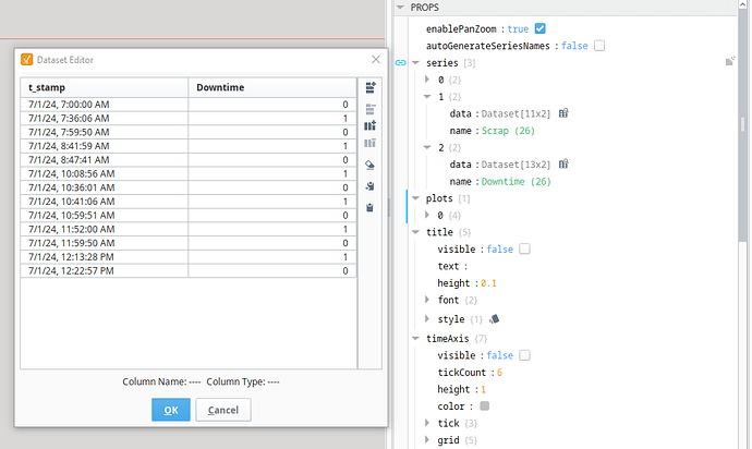

> Of course -- first step is to get your downtime data pulled in and formatted like so:
> ![image](https://us1.discourse-cdn.com/inductiveautomation/original/3X/7/c/7cbe7e49532d5bd9d6f65734adcdc843858cb8f1.png)
> When a section of downtime begins, the value at that timestamp should be 1. When that same section of downtime ends, the value at that timestamp should be 0. This creates a basic step function. I can show you the named query I used to get my data like this, but your data might be completely different than mine. Just let me know if you run into issues there.

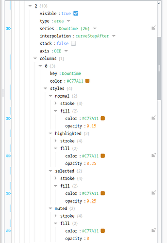

> Next, you just need to set up an additional trend on that time series chart with a configuration like this:
> ![image](https://us1.discourse-cdn.com/inductiveautomation/original/3X/0/e/0e0b2211ed2df6719c05dde8fd0caaecb7fb9314.png)
> The key values to note here are `type: area` and `interpolation: curveStepAfter`. Those settings combined with the low opacity column color selections together create the semi-transparent overlay effect.
