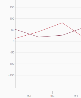

Hi Everyone.
I have a question.
When I am trying to put min/max to axis like -150/150, so the axis looks like -200/200
When I put -140/140, so the axis looks that way what I need it looks like - -140/140
So… what’s wrong with -150/150 limits?
Thanx in Advance 🙂
GOOD (-140/140):
 ![image](https://us1.discourse-cdn.com/inductiveautomation/original/3X/f/5/f5a274337a9ee9bbb40016720d14fb28254fcf3b.png)
NOT GOOD (-150-150):
 ![image](https://us1.discourse-cdn.com/inductiveautomation/original/3X/2/9/29fc69a213db4d45b1cc216fc9d671a90c927705.png)

**Post date:** [November 18, 2025, 10:41am UTC](https://forum.inductiveautomation.com/t/perspective-timeseries-chart-axis-scaling/112247/4 "2025-11-18T10:41:47Z")
what’s your `plots[x].axes[y].tick.count` set to? this will determine the values you see. It seems like if this is set to `Auto`, that’s when the max can go above the max you set. If you set a fixed tick count, then it honours it

**Post date:** [November 18, 2025, 10:47am UTC](https://forum.inductiveautomation.com/t/perspective-timeseries-chart-axis-scaling/112247/8 "2025-11-18T10:47:57Z")
That’s because the tick count you set isn’t divisible by your range. If it’s dynamic, then you need to bind the tick count and calculate the number of ticks so that it gives round tick numbers.
E.g. if you have -150 to 150 and want it to increment by 50, 150- -150 = 300, 300/50 = 6. You have to add 1 to get 7 ticks.
 ![image](https://us1.discourse-cdn.com/inductiveautomation/original/3X/6/7/67f656c52ced58b1ec64fd222c2569081aaf104c.png)
It’s not as nice as just setting it to Auto…

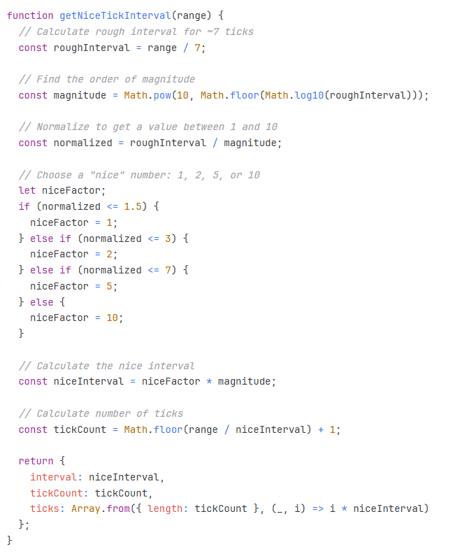

Claude helped a bit - see the original below
 ![image](https://us1.discourse-cdn.com/inductiveautomation/original/3X/6/5/65c830b9a4b7f51dd9cda869c41c910f0d64d7e1.png)
It could do with some tweaking for some ranges like 150, 75
