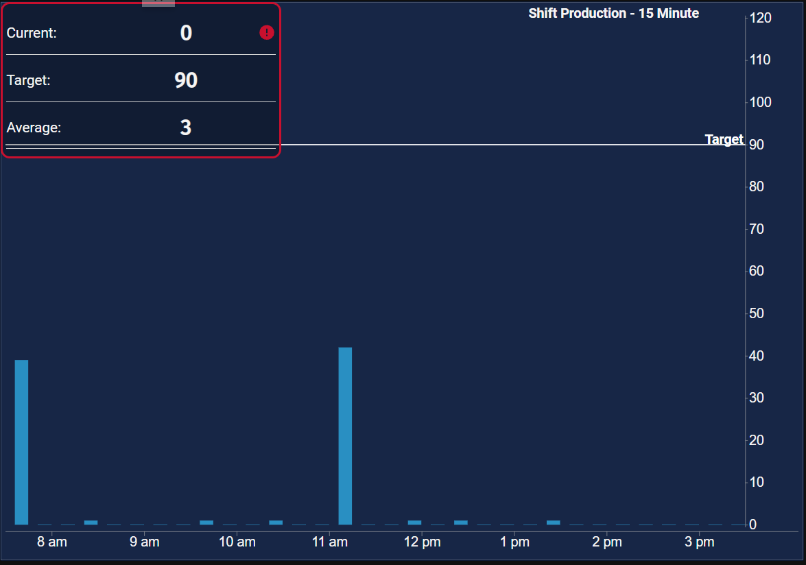

Hello everyone,
I'm hoping to get some assistance with a chart modification I'm working on.
I’d like to color-code each bar in my timeseries chart based on specific logic. However, I haven’t been able to find a built-in feature or workaround that supports this functionality.
Here’s what my current timeseries chart looks like:
 ![image](https://us1.discourse-cdn.com/inductiveautomation/original/3X/1/f/1ff86f1b22fbd0f69c34e46324dd7d21fd1119f5.png)
My initial thought was to switch to an XY Chart and use the deriveFieldsFromData option to achieve the desired bar coloring:
 ![image](https://us1.discourse-cdn.com/inductiveautomation/original/3X/1/e/1ef90cd4b51dbf24aac9b9959b857b735daa765b.png)
Unfortunately, switching to the XY chart results in the loss of the target baseline feature, which is important for my use case.
Does anyone have suggestions for either:
1: Applying conditional coloring to individual bars in a timeseries chart, or
2: Implementing a baseline with custom labeling across the screen in an XY chart?

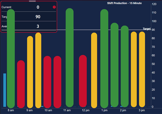

The image below would be my expected output:
 ![image](https://us1.discourse-cdn.com/inductiveautomation/original/3X/e/d/ed28cc5aee3a7db08f103b2aa9ca3e7cd9a0443f.png)

**Author:** ![MMaynard](https://sea1.discourse-cdn.com/inductiveautomation/user_avatar/forum.inductiveautomation.com/mmaynard/32/3366_2.png) [@MMaynard](https://forum.inductiveautomation.com/u/MMaynard)\
**Post date:** [September 8, 2025, 3:00pm UTC](https://forum.inductiveautomation.com/t/perspective-timeseries-chart-column-coloring/110421/3 "2025-09-08T15:00:13Z")
You can do a transform on the dataset and insert the colors you want.
The below example I am just returning a random color from a function, since we just want different colors on each bar. But you could easily assign colors by value, or label, etc.
```python
def transform(self, value, quality, timestamp):
    nds = []
    pds = system.dataset.toPyDataSet(value)
    for row in pds:
        nds.append({"x":row[1],"y":row[0]})
    self.props.data.datasets[0].data = [row[0] for row in pds]
    self.props.data.labels = [row[1] for row in pds]
    self.props.data.datasets[0].backgroundColor = [project.Useful.randColorHex() for row in pds]

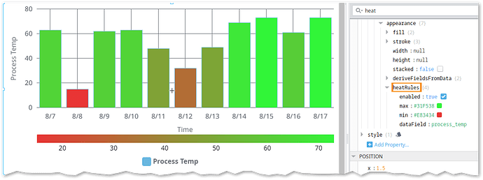

**Post date:** [September 8, 2025, 3:05pm UTC](https://forum.inductiveautomation.com/t/perspective-timeseries-chart-column-coloring/110421/4 "2025-09-08T15:05:04Z")
While it's not quite what you want, here's the XY Chart heatmap.
 ![image](https://us1.discourse-cdn.com/inductiveautomation/original/3X/1/7/17ad2ba60634a214a2ddb2770b3bb75bd7084d06.png)
You can add the target line with a line plot. You just need to supply it with two points, (tmin, y) and (tmax, y).
**Author:** ![Noah\_Casey](https://avatars.discourse-cdn.com/v4/letter/n/e480ec/32.png) [@Noah\_Casey](https://forum.inductiveautomation.com/u/Noah_Casey)\
**Post date:** [September 8, 2025, 3:29pm UTC](https://forum.inductiveautomation.com/t/perspective-timeseries-chart-column-coloring/110421/5 "2025-09-08T15:29:17Z")
Does this method work for the timeseries chart?
I tried changing the data from a dataset to the following structure:
 ![image](https://us1.discourse-cdn.com/inductiveautomation/original/3X/d/f/dff29a6f643d2698ebf21c79193b9fd55c988bd3.png)
I tried backgroundColor, color, Style –\> backgroundColor
I also removed any other color related values to a default of ‘‘ to ensure those would not overwrite my manually input colors and I am still seeing the regular color appear.
**Post date:** [September 8, 2025, 3:43pm UTC](https://forum.inductiveautomation.com/t/perspective-timeseries-chart-column-coloring/110421/6 "2025-09-08T15:43:20Z")
You would need to set the colors under the default styles for the standard time series chart.
```python
self.props.defaultStyles.colors
 ![image](https://us1.discourse-cdn.com/inductiveautomation/original/3X/3/4/349d58ec9473e01a31be1d0f28e98962d11a1213.png)
**Post date:** [September 8, 2025, 4:04pm UTC](https://forum.inductiveautomation.com/t/perspective-timeseries-chart-column-coloring/110421/7 "2025-09-08T16:04:52Z")
Thank you for the help I used this method to parse out my data to Above/Below target then colored those columns specifically.
