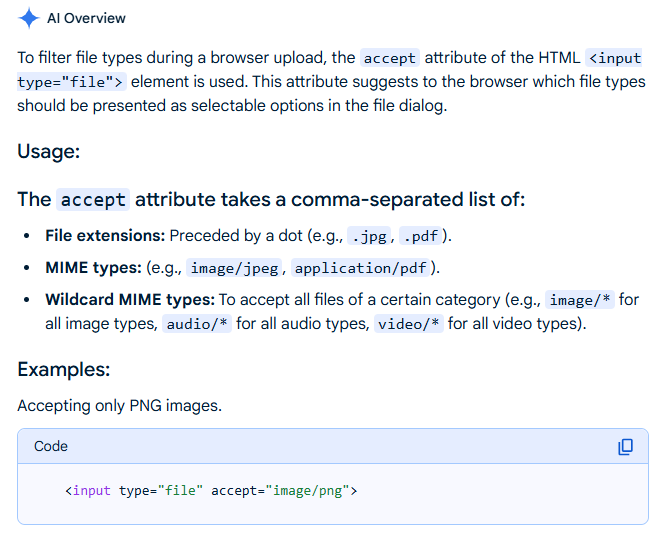

I agree this is the case, but we could have influence browser to only upload certain types of file.
 ![image](https://us1.discourse-cdn.com/inductiveautomation/original/3X/1/e/1ea5c6b8041d0226f083762b1987eed3474fac48.png)
**Post date:** [October 12, 2025, 8:06pm UTC](https://forum.inductiveautomation.com/t/perspective-upload-component-can-you-filter-files-to-be-upload/111365/6 "2025-10-12T20:06:52Z")
Check your html. I thought Perspective's `supportedFileTypes` mapped directly to that `accept` property.
