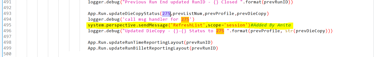

I am calling in session scope like below in script library function of child project.
 ![image](https://us1.discourse-cdn.com/inductiveautomation/original/3X/a/f/af8373e5a0294568eedc702c1710b7e3f5e31a63.png)

**Post date:** [September 17, 2025, 3:28am UTC](https://forum.inductiveautomation.com/t/perspective-view-taking-too-long-to-load/110508/10 "2025-09-17T03:28:56Z")
> [@Anita.Shinde](#):
That doesn't show how that project library is called. So no, that doesn't definitively show session scope.
**Author:** ![Anita.Shinde](https://avatars.discourse-cdn.com/v4/letter/a/c2a13f/32.png) [@Anita.Shinde](https://forum.inductiveautomation.com/u/Anita.Shinde)\
**Post date:** [September 17, 2025, 5:56am UTC](https://forum.inductiveautomation.com/t/perspective-view-taking-too-long-to-load/110508/11 "2025-09-17T05:56:17Z")
That project library is called in gateway events tag change script.
**Post date:** [September 17, 2025, 11:34am UTC](https://forum.inductiveautomation.com/t/perspective-view-taking-too-long-to-load/110508/12 "2025-09-17T11:34:01Z")
> [@Anita.Shinde](#):
Then it is Pure Gateway Scope, and not Session scope. I'm not sure that `system.perspective.sendMessage()` will work here.
I would default to `system.util.sendMessage()`

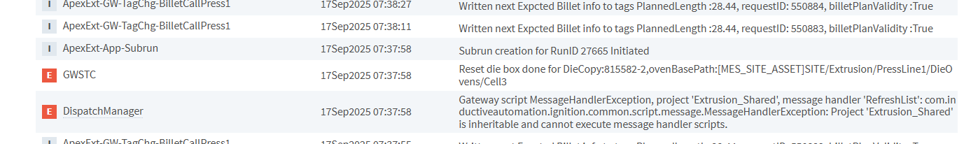

**Post date:** [September 17, 2025, 12:09pm UTC](https://forum.inductiveautomation.com/t/perspective-view-taking-too-long-to-load/110508/13 "2025-09-17T12:09:10Z")
what should be the projrct name in system.util.sendMessage()?(parent or child project)
I want to refresh the view which is inherited in child project and project library script also in child project.
showing below error when I am passing parent project name
 ![image](https://us1.discourse-cdn.com/inductiveautomation/original/3X/a/1/a172ea14fe2c9af6c85807a2364b031015bda77a.png)
and this is error when child project name is given
![image](https://us1.discourse-cdn.com/inductiveautomation/original/3X/e/f/ef198895646cab6ce58d7b2687d8b755240c65bc.png)
**Post date:** [September 17, 2025, 1:55pm UTC](https://forum.inductiveautomation.com/t/perspective-view-taking-too-long-to-load/110508/14 "2025-09-17T13:55:34Z")
It should be the project where the message handler is located.
Make sure that the name you used for the message handler matches exactly.
Also insure that you have saved the project after adding the handler.

**Post date:** [September 17, 2025, 2:15pm UTC](https://forum.inductiveautomation.com/t/perspective-view-taking-too-long-to-load/110508/17 "2025-09-17T14:15:52Z")
The project name should be the name of the project where the message handler is located. The message handler will be running in the child project so that project name should be used.

**Post date:** [September 17, 2025, 3:36pm UTC](https://forum.inductiveautomation.com/t/perspective-view-taking-too-long-to-load/110508/19 "2025-09-17T15:36:39Z")
Yes, you are not sending the message to 'Session' scope.
```python
system.util.sendMessage(system.util.getProjectName(),'RefreshList')
or
```python
system.util.sendMessage(system.util.getProjectName(),'RefreshList',scope='S')
Also, I just caught this:
> [@Anita.Shinde](#):
> message handler located in parent project
message handlers should not be in inheritable projects, they should be located in the project you are actually running.
**Author:** ![ryan.white](https://sea1.discourse-cdn.com/inductiveautomation/user_avatar/forum.inductiveautomation.com/ryan.white/32/73193_2.png) [@ryan.white](https://forum.inductiveautomation.com/u/ryan.white)\
**Post date:** [September 17, 2025, 3:46pm UTC](https://forum.inductiveautomation.com/t/perspective-view-taking-too-long-to-load/110508/20 "2025-09-17T15:46:47Z")
It should be noted that if you are using `system.util.sendMessage`, your perspective message handler will need to re-broadcast the received message or broadcast a different message with `system.perspective.sendMessage` for any open views in a session to receive a message.
The `system.perspective.sendMessage` call in the perspective message handler will only work with a scope of `session`
Component and view message handlers will not receive messages from a `system.util.sendMessage` call.
