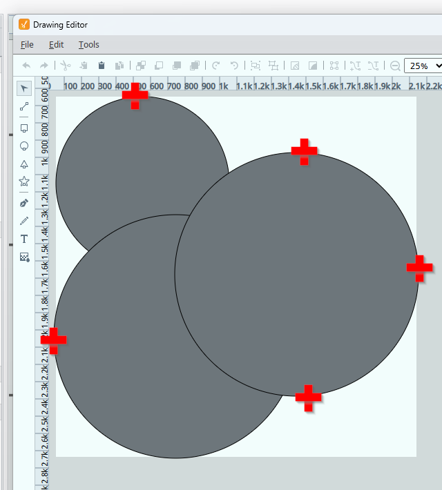

With regard to the pipe drawing tool in the perspective module, is there a way to change the position of piping anchor points on components?

I've had a play with defining piping anchor points. If you convert the standard Perspective components to a drawing, you can see how the anchors are defined. Anchor points are circles with radius of 0 and a style class of `ia_drawingComponent__pipingAnchor`.
I have successfully defined custom anchor points by replicating this configuration on drawing components.
The issue I am hitting is when I want to define anchor points on a drawing within an embedded view. What ever logic is implemented to search for the pipingAnchor class does not work when using an embedded view. It would be great if we could get this updated.
Another recommendation is to add a ' **Create Piping Anchor button**' to the drawing tools!

It would be nice to be able to define custom anchors through the drawing editor.
