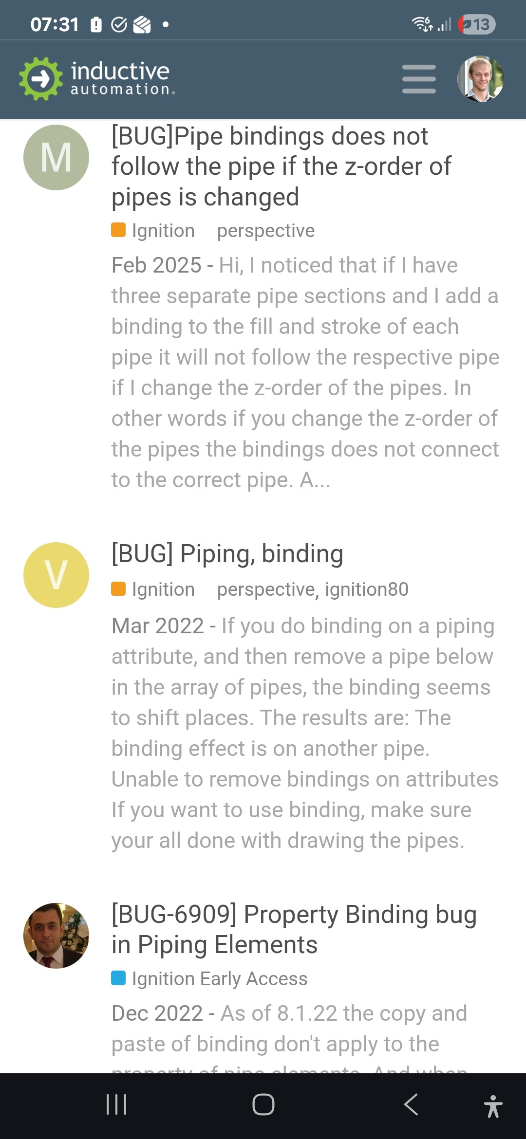

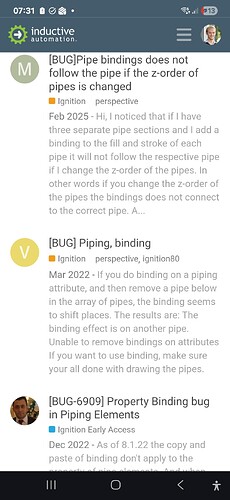

Instead of a map transform with magic colours though, I would _strongly_ suggest using css colour variables instead (you can't use style classes unfortunately with pipes else I would have recommended those).
I think there was a issue with pipe bindings though when you changed their order, or something. I only recall reading about it a while ago
 ![Screenshot20260610073142Chrome](https://us1.discourse-cdn.com/inductiveautomation/original/3X/b/c/bca44f9f49a6c7ecf901f5ce77b074ea46eb99bf.jpeg)
Bindings on pipes seem pretty fragile given the entire pipe structure can be easily modified. And given how complex and time intensive pipe animation can be, this could quickly become a nightmare. This has given me something to think about for an upcoming project to solve since I'll need to have pipe animations... I think the only good option might be to script it outside of the pipe structure and write to the pipe colours themselves by naming the pipe sections properly. I think @nader.chinichian might have done something similar?
