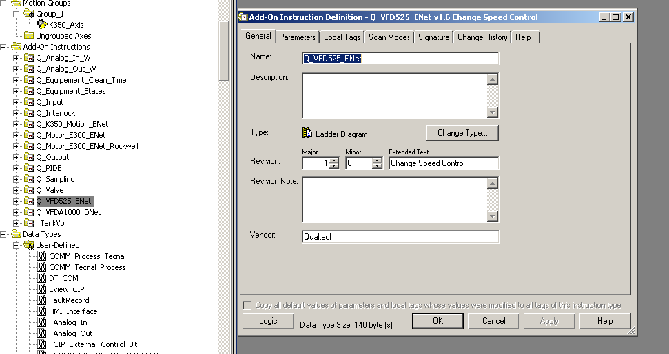

OK,
here is what we done. I will use an Ethernet VFD as an example. We took the Rockwell AOI and stripped out all the BS an nonsense, and optimized it as our own:
 ![](https://us1.discourse-cdn.com/inductiveautomation/original/2X/d/d07ae3fed59d88b407f0ab08839524ea7ebb0dbc.png)
 ![](https://us1.discourse-cdn.com/inductiveautomation/original/2X/c/ce0e11b2ac4d6c19a4525b9e760dc95e5cab4640.png) ![](https://us1.discourse-cdn.com/inductiveautomation/original/2X/b/b285040ae16cc3d72298412627cdbfa71261ec70.png)
In Ignition a Template tag was created my ‘moi’ to point to this AOI
 ![](https://us1.discourse-cdn.com/inductiveautomation/original/2X/6/6b7227381d50db999e0ae67fd9bc6f9f534fa8f9.png)
 ![](https://us1.discourse-cdn.com/inductiveautomation/original/2X/1/1020348e449689d8273ccec947e57ea1263e2dc8.png)
I created a template based on the PlantPax template for a VFD. When area around pump is pressed, template popup is called passing the template tag as a parameter
 ![](https://us1.discourse-cdn.com/inductiveautomation/original/2X/e/e3c46cdd175dee2ac4d0ae585cbe87f9f82414b9.png) ![](https://us1.discourse-cdn.com/inductiveautomation/original/2X/6/62e141ff459a61e6d40551e58204989b6ec34d03.png)
![](https://us1.discourse-cdn.com/inductiveautomation/original/2X/1/12a104a0e68066b5b2836b916a71da4812750b0c.png)
![](https://us1.discourse-cdn.com/inductiveautomation/original/2X/9/9701caf32c86f3fe07a72a647e6ea2588f024118.png)
![](https://us1.discourse-cdn.com/inductiveautomation/original/2X/7/77afc15178b608fc49425dc681f3d960a2333c33.png)
I need to add that each of the ‘tabs’ are just a container that has visibility enabled based on the menu button pressed.
Home button sets display property to 0, Info button sets a display property to 1, etc.
Each container’s visibility is based on value of the property.
0 = Home Visible
1 = Info visible
etc
Indirect template tags are used every where, where the path to the template tag is passed into this ‘popup’ as a parameter.
