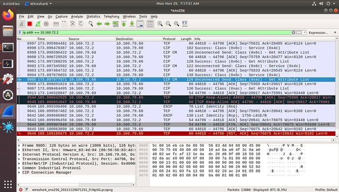

We are encountering a similar issue today on the primary server in a redundant pair, and we are running 8.1.7. ALL of the PLC connections where we have pulled tags into the designer are showing **Idle** after a period of time. Even if I create a new connection, it goes online for a little bit, and then it goes idle. We have been running on our backup server all day as a result.
I don’t think it is related to the bug that was fixed with 8.1.4, but we’re at a loss for how to proceed. We have a ticket open with IA, but we haven’t gotten a response yet so I thought I would put something in the forum.
**Edit:** Also, I captured some packets on the server, and it appears that Ignition actually sends a **FIN** packet after I created a new connection, which caused the PLC to respond with a **RST** packet.
 ![Wireshark Capture](https://us1.discourse-cdn.com/inductiveautomation/original/3X/8/6/867b7f4db870e49ea12d135d6f660045296500c7.jpeg)
Also, if I open one of the device connections and hit **Save** the Gateway just sits and spins. At one point last night, I think I waited something like 20-30 minutes or more, and it never finished saving the connection. However, if I just click on devices while it is spinning, the connection shows up _as if_ it had been saved.
**Post date:** [November 29, 2021, 6:40pm UTC](https://forum.inductiveautomation.com/t/plc-stuck-in-idle-status-periodically/43489/9 "2021-11-29T18:40:02Z")
Setting these loggers to DEBUG might help:
- `com.digitalpetri.enip.ChannelFsm`
- `drivers.LogixDriver.LogixBrowseStateManager`
- `com.inductiveautomation.xopc.drivers.logix.cip.CipConnectionPool`
Also if you want to send me a Wireshark capture I can take a look.

That would be great! The Ignition server is 10.160.79.60, and it is trying to connect to a PLC at 10.160.72.1. There already was a device in the Gateway for this IP, but there was no traffic whatsoever even though we have hundreds of tags Ignition should be monitoring. For this capture, I added a new device at that IP two separate times.
[Ignition Traffic to 10.160.72.1.pcapng](https://forum.inductiveautomation.com/uploads/short-url/60nVYOILuTfkPzIxk8KFcxs66N0.pcapng) (885.6 KB)
You should see a bunch of ARP traffic at the top, and then some pings when I made sure the network connection was working fine. Then you should see when I established the connection both times by seeing the TCP and CIP packets.
**Edit:** Also, I turned on DEBUG for the times you mentioned, but I can't upload the log files to this forum because they are too large.
**Edit 2:** Sorry, I just realized I put the wrong IP for the Ignition server in this post above. I have corrected it. The correct IP is 10.160.79.60.
**Post date:** [November 29, 2021, 7:15pm UTC](https://forum.inductiveautomation.com/t/plc-stuck-in-idle-status-periodically/43489/11 "2021-11-29T19:15:16Z")
I can’t fully explain what is going on in the capture. Twice, it shows the driver connecting, browsing, then a ~15 second delay before a ListIdentity request is issued followed by what appears to be the client disconnecting.
The ListIdentity is issued as a keep-alive when the connection is otherwise quiet, and although it appears to succeed in the Wireshark capture, it seems the driver thinks it failed for some reason. If you can turn the logger `com.digitalpetri.enip.EtherNetIpClient` to DEBUG it might show more information about why.
At this point the driver transitions to an “Idle” state, which means it’s waiting for something to try to use the connection before reconnecting.
That nothing is trying to use the connection seems to be a separate issue… do you have tags subscribed against this driver?
**Post date:** [November 29, 2021, 7:15pm UTC](https://forum.inductiveautomation.com/t/plc-stuck-in-idle-status-periodically/43489/12 "2021-11-29T19:15:54Z")
I am curious what you find, Kevin. The FIN comes immediately after a List Identity reply that contains CPF type code 0x0086.
**Post date:** [November 29, 2021, 7:17pm UTC](https://forum.inductiveautomation.com/t/plc-stuck-in-idle-status-periodically/43489/13 "2021-11-29T19:17:53Z")
Ah, I saw that, but now that you mention it I do remember having to add support for that item to the ENIP library. Need to see what version that happened in…

So we might be making progress. We have installed the trial version of a module for switching from class 3 to class 1 communication. The IA tech (Alex) who was looking at my coworkers screen indicated that something appeared to be blocking a thread, so we deleted that device (not the module) and restarted the gateway. So far, it appears that the gateway has maintained the connection to the PLCs.
**Post date:** [November 29, 2021, 7:20pm UTC](https://forum.inductiveautomation.com/t/plc-stuck-in-idle-status-periodically/43489/15 "2021-11-29T19:20:57Z")
Volume 2 Edition 1.27 April 2021. Not in Edition 1.25 Nov 2019. I’m missing Edition 1.26 for some reason.

**Post date:** [November 29, 2021, 7:25pm UTC](https://forum.inductiveautomation.com/t/plc-stuck-in-idle-status-periodically/43489/20 "2021-11-29T19:25:30Z")
It doesn’t look like the Logix driver uses a new enough version of the ENIP library to support that CIP security item in the ListIdentity response, and when coupled with a device with no tags or a long enough period with no activity the keep-alive kicking in and issuing a ListIdentity request is causing this.
Not sure about the other devices though.
