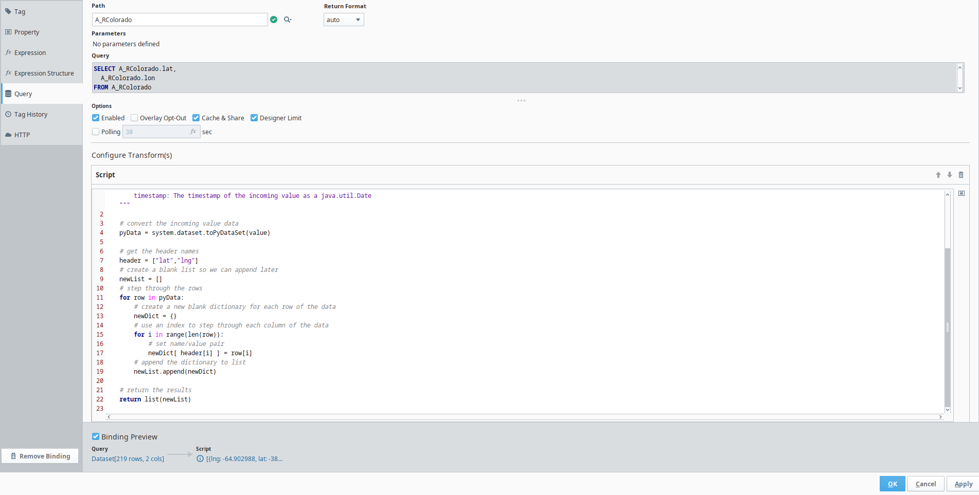

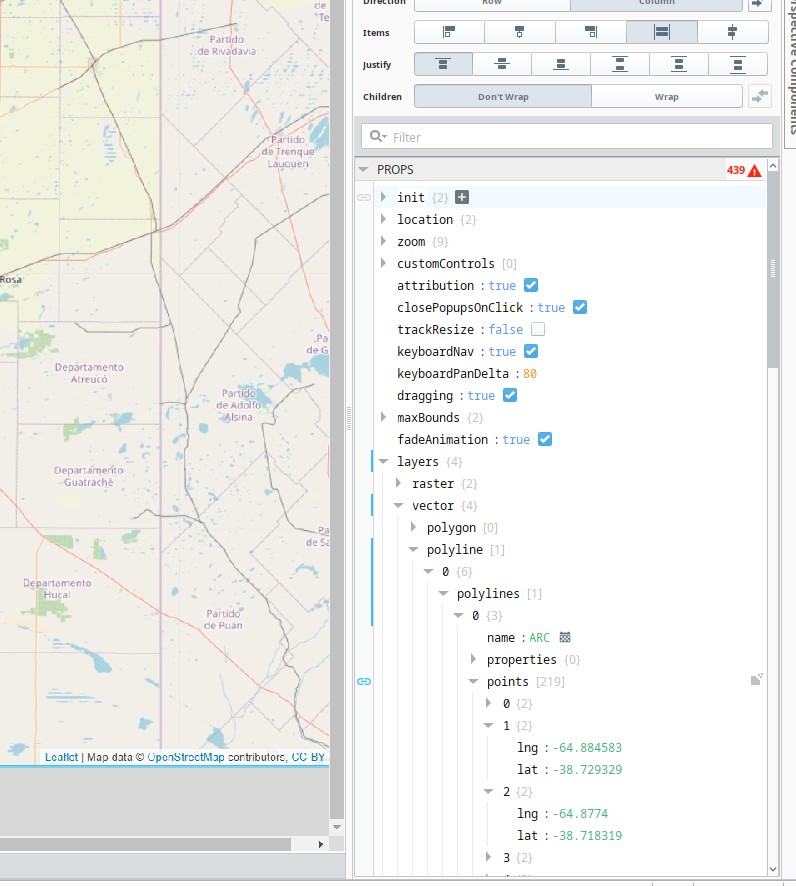

Hello everyone, I have a problem that I want to share with you. I want to display a series of aqueduct lines in the map component, for which I have point-to-point coordinates entered into a database. To extract them, load a query name with the data and then try to bind it using a Query binding followed by a script that assigns it to lat and lng objects. But although they seem to be loaded correctly, the designer tells me an error (layers.vector.polyline[0].points[1].lng: string found, number, null expected), which according to my understanding is due to the data type, and I still can’t solve this. I am interested to know if someone can think of a solution or a simpler way to perform the same data acquisition process.

> [@Gregorio\_Casparri](#):
That path doesn't line up with the section of the property editor you've shown in the screenshot; what do the values look like in the `points` array?
Also, it's probably not relevant to your issue, but I'm pretty sure your transform script could be reduced to something like this:
```auto
pds = system.dataset.toPyDataSet(value)
return list(dict(row) for row in pds)
Or as a comprehension:
```auto
return [
		"lat": lat,
		"lng": lng
	} for lat, lng in pds

How are your long and lat values stored in the database?
If they are stored as strings, they will need converting to floats.
