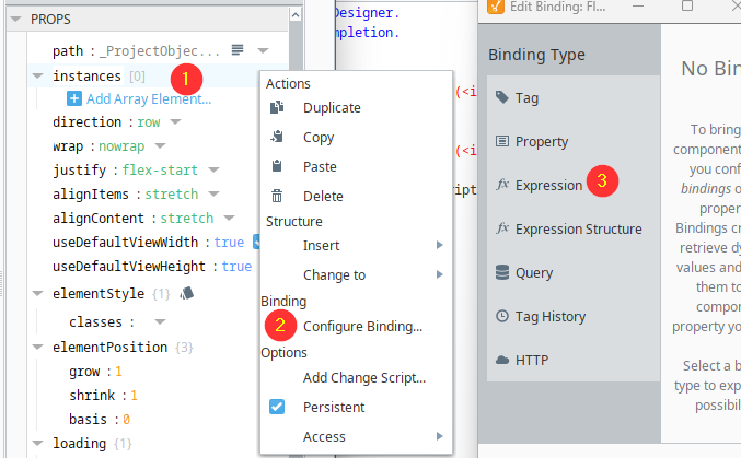

You mean binding like this ?
 ![image](https://us1.discourse-cdn.com/inductiveautomation/original/3X/2/e/2ee0774c74c09a555c9d1223f69bbe86f2eacf97.png)
Can you point me to an example please?
**Author:** ![Steve\_Laubach](https://sea1.discourse-cdn.com/inductiveautomation/user_avatar/forum.inductiveautomation.com/steve_laubach/32/60900_2.png) [@Steve\_Laubach](https://forum.inductiveautomation.com/u/Steve_Laubach)\
**Post date:** [July 21, 2025, 5:12pm UTC](https://forum.inductiveautomation.com/t/populate-flexrepeater-instances-automatically-on-page-load/108732/4 "2025-07-21T17:12:38Z")
There's a lot of ways to do it.
Bind to whatever condition you want to use to make it load content. Then use a script transform on the binding to build the json that loads instances of your view inside the flex repeater.

**Post date:** [July 21, 2025, 10:35pm UTC](https://forum.inductiveautomation.com/t/populate-flexrepeater-instances-automatically-on-page-load/108732/6 "2025-07-21T22:35:35Z")
I wouldn't use an onStartup event. I would use a binding with a script transform regardless if you want to run it on load or on change of something, as then it's directly attached to the component and is obvious. Something in an onStartup script is less obvious.
If you just want it to run once, use an expression binding and set the expression to simply `1`

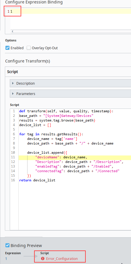

**Author:** ![Anant\_Upadhyayula](https://avatars.discourse-cdn.com/v4/letter/a/e36b37/32.png) [@Anant\_Upadhyayula](https://forum.inductiveautomation.com/u/Anant_Upadhyayula)\
**Post date:** [July 22, 2025, 1:36pm UTC](https://forum.inductiveautomation.com/t/populate-flexrepeater-instances-automatically-on-page-load/108732/7 "2025-07-22T13:36:07Z")
Thank you @vtran & @nminchin for your help. It worked great, now I have a beautiful table dynamically populating and giving connection status of all PLCs. However I ended up using on startup.
@nminchin is this what you mean ? I thought transform was to modify the value. How 1 can be transformed to pull the data script ?
 ![image](https://us1.discourse-cdn.com/inductiveautomation/original/3X/7/4/74c35733942c353d4c3a285efb4b2829ca31db05.png)
**Post date:** [July 22, 2025, 2:09pm UTC](https://forum.inductiveautomation.com/t/populate-flexrepeater-instances-automatically-on-page-load/108732/8 "2025-07-22T14:09:35Z")
no worries figured it out, it was missing `return value` in the end
