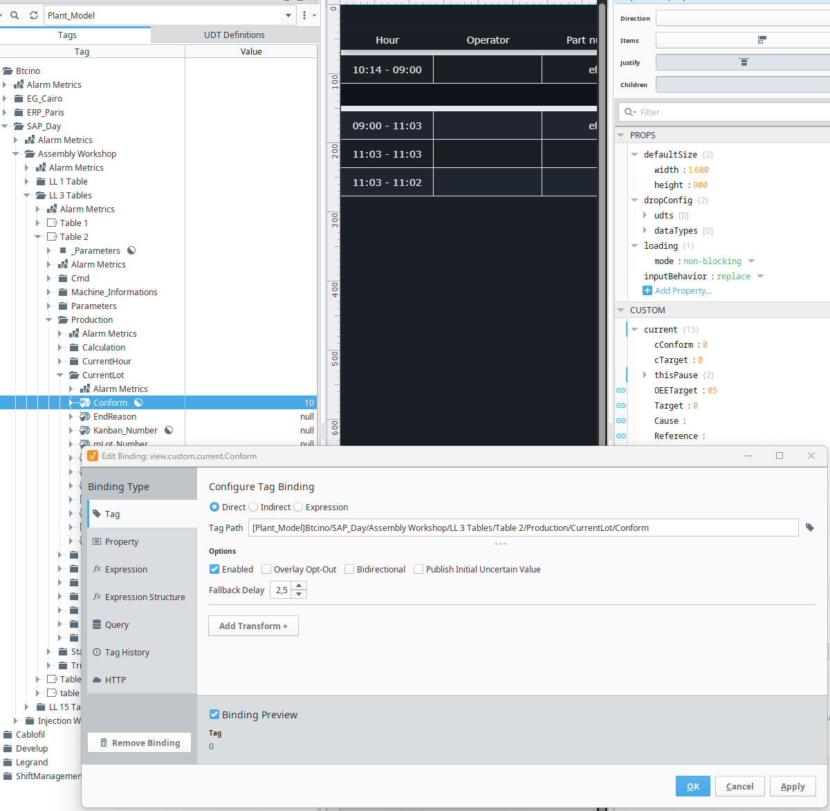

However, I would like to add another feedback. Today I encountered a similar issue on another one of our gateways running **8.3.3**.
In a Perspective page, I have several custom properties. One of them constantly returns 0, but only for one specific UDT instance.
This happens whether the property is bound through an expression binding:
 ![image](https://us1.discourse-cdn.com/inductiveautomation/original/3X/9/7/97776ff5b25a1a0e0ad70362a203a0bee4471dee.png)
or through a direct tag binding:
 ![image](https://us1.discourse-cdn.com/inductiveautomation/original/3X/d/c/dcaee2f362d426df49b70fe76757c1922d3379ca.png)
As shown in the screenshots, the displayed result is always 0, while the actual tag value is 10.
Again, the only way to get the correct value is to explicitly reference .value. Once **.value** is added, the correct value is returned.
 ![image](https://us1.discourse-cdn.com/inductiveautomation/original/3X/a/5/a57b58d4d675d17ba667a06db73599b9b901faf5.png)
Adding **.value** itself is not a problem. The main issue is that it would require us to modify all of our Ignition projects for this newer version. At first glance everything seems to work correctly, but in some specific UDT instances this bug appears, which ends up creating unexpected and confusing behaviors for users in the application.
So it is difficult for us to reliably detect where this issue might occur, **but as soon as I click on “Restart tags” in the designer in the folder that is causing the problem, the error disappears.**
**Post date:** [March 5, 2026, 4:25pm UTC](https://forum.inductiveautomation.com/t/possible-bug-with-query-tags-and-implicit-value-in-ignition-8-3-1/114316/6 "2026-03-05T16:25:43Z")
I'd definitely contact support at this point.
It seems like there might be something going on within the tag execution system that's manifesting as these symptoms in two different areas.
