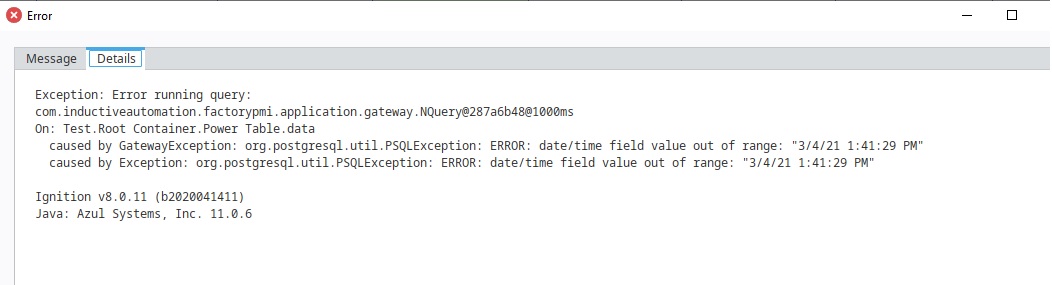

I changed it to this format M/d/yy h:mm:ss a
and now I get a different error
 ![ERROR](https://us1.discourse-cdn.com/inductiveautomation/original/3X/9/b/9b6b5ac263cf8b20ea009f89722e81a2023b1dd7.jpeg)

works if I go with date only like this yyyy-MM-dd

Maybe understanding PostgreSQL’s `TO_TIMESTAMP()` function might be helpful.
Try this article: [PostgreSQL TO\_TIMESTAMP() Function By Practical Examples (postgresqltutorial.com)](https://www.postgresqltutorial.com/postgresql-to_timestamp/).

**Author:** ![casian](https://avatars.discourse-cdn.com/v4/letter/c/b19c9b/32.png) [@casian](https://forum.inductiveautomation.com/u/casian)\
**Post date:** [March 4, 2021, 11:15pm UTC](https://forum.inductiveautomation.com/t/postgresql-query-to-timestamp/44121/12 "2021-03-04T23:15:31Z")
> [@cesrom](#):
> YYYY-MM-DD HH:MI:SS
Damn, I had to do for this format YYYY-MM-DD HH24:MI:SS but it worked 😜
I actually read that article earlier but it never hit me.
Thanks a lot!
**Post date:** [March 4, 2021, 11:33pm UTC](https://forum.inductiveautomation.com/t/postgresql-query-to-timestamp/44121/13 "2021-03-04T23:33:27Z")
Y’all are asking for future trouble. If you can use a named query, then there is _ **NO** _ reason to convert your timestamp to a string and then back to a timestamp in PostgreSQL. Simply use a value parameter of type datetime (which is perfectly compatible with PostgreSQL timestamptz and friends). The precise UTC value of your timestamp will be passed in binary format through JDBC. Faster, too.
If you are formatting a date/time as a string to get your DB to interpret it, you are almost certainly screwing up.
