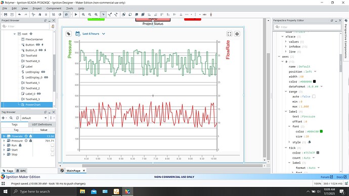

It's coming together but I still would like a little tweaking, but can't find what I would like to change.
Can someone please help me with some of the "Properity Settings" for the Power Chart?
Here's what I trying to change. BOTH the Pressure & FlowRate "Min & Max" values I would like to be just a little bit larger and in BOLD.
The Time at the bottom I would like to be in BOLD.
The pressure line has flat spots but the flowrate does not it has sharp transitions, I would like my pressure not to have the flat spots but show sharp transitions also?
Can someone please help? I am reading the manual but it's still confusing.
 ![PowerChart](https://us1.discourse-cdn.com/inductiveautomation/original/3X/8/f/8f422eb6b135e011c709df36a81263e9125cacea.jpeg)

The pressure vs flow data is likely a function of how each tag is historically configured. Check those settings. Also check the interpolation settings.

I have checked to make sure the settings for each tag is exactly the same and I also looked at the interpolation settings for each Pen/display setting and they are the same also. What about the min and max for is there a way to make the font a little bigger and in bold?

OK, I have finally figured out everything I need except I can't find out how to change the pressure trend so that it does not have the "Flat" spots.

On your tag historian setting, do you have one set as discrete and one as analog or auto? Are you doing on change with a deadband? The top one looks like discrete, and the bottom one looks like analog with interpolation.

They are both set the same. Maybe I should just delete the chart and tag historian and start all over. STRANGE!

Well, I deleted my original Power Chart and added a fresh Power Chart Component. Left my "Tag Historian" the same, and all works as it should.
I think I now have this configured the way I need. Thanks to everybody for the help.
