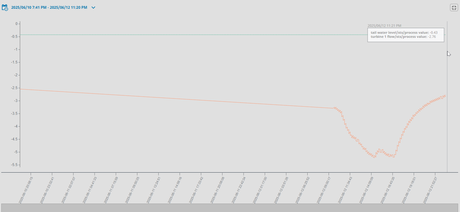

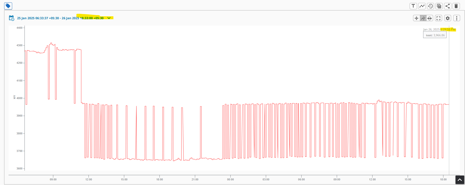

Hi Guys,
I am using power chart i have selected historical mode
I have noticed it its showing -10 or -5 mins offset from the actual end time in chart. Its happening most of the tags
I couldn't able to find out the reason for the issue. can you please help me out
My actual end time is 6:33pm but its showing data up to 6:29pm when i export the file also its showing up to 6:29
**Point count i mentioned -1**

**Post date:** [June 12, 2025, 2:08pm UTC](https://forum.inductiveautomation.com/t/power-chart-end-time-is-not-showing-correctly/107326/2 "2025-06-12T14:08:17Z")
Have you confirmed there's data actually recorded in the raw tables for the last few minutes that seem to be missing? Is 18:33 in the screenshot the current time at the time of the screenshot? or is it in the past?

**Post date:** [June 12, 2025, 2:13pm UTC](https://forum.inductiveautomation.com/t/power-chart-end-time-is-not-showing-correctly/107326/3 "2025-06-12T14:13:33Z")
I would start by querying that set of data through the script console or into a table on a view and then match up the timestamps.
The other thing you could look at is how you are doing the timezone conversion on your historical selection. 06:33:37 **+05:30**.

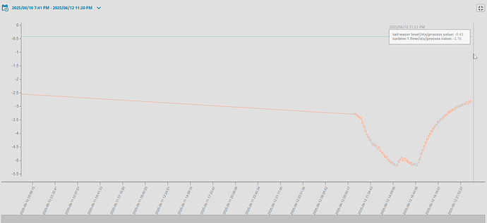

**Post date:** [June 12, 2025, 2:16pm UTC](https://forum.inductiveautomation.com/t/power-chart-end-time-is-not-showing-correctly/107326/4 "2025-06-12T14:16:43Z")
Actually, I'm seeing the same thing...
 ![image](https://us1.discourse-cdn.com/inductiveautomation/original/3X/c/6/c6b8c7c8f99d1654997b45cc0c7f93affdf7de47.png)
The pen display ends around 23:11 instead of 23:20 which is the historical period end. It's currently 23:50, and there is definitely data from 23:11 to 23:20.
As a side note, gotta love those datetime values... 20:08:08, 22:32:44, ... what kind of increments are they??
**Author:** ![prasath.t](https://avatars.discourse-cdn.com/v4/letter/p/898d66/32.png) [@prasath.t](https://forum.inductiveautomation.com/u/prasath.t)\
**Post date:** [June 12, 2025, 2:36pm UTC](https://forum.inductiveautomation.com/t/power-chart-end-time-is-not-showing-correctly/107326/5 "2025-06-12T14:36:02Z")
yes data is there for 6:29 then next data in database is 6:35. May be that's y its not showing data in export file
One more question if i give point of count 300, then iit should interpolate and show up to 6:33?
I have given 300 point of count, now its showing up to 6:26 only
**Post date:** [June 12, 2025, 2:38pm UTC](https://forum.inductiveautomation.com/t/power-chart-end-time-is-not-showing-correctly/107326/6 "2025-06-12T14:38:17Z")
I am just mentioning current time zone in that label
