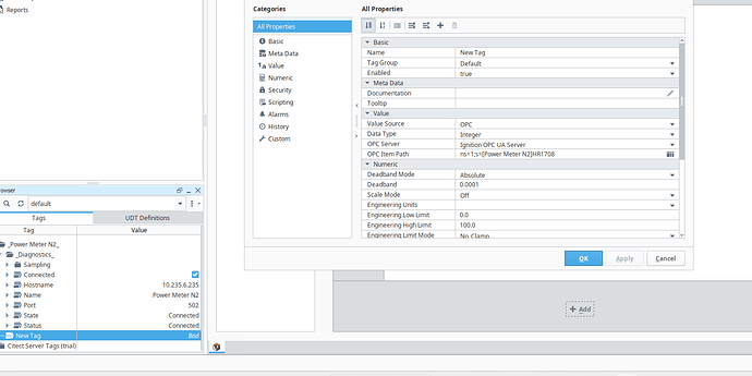

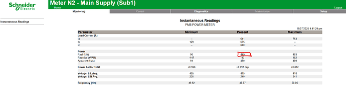

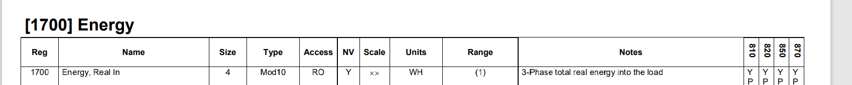

Hi all,
Pretty new to Modbus, how do I set up this register to be displayed in tag browser?
I tried ns=1;s=[Power Meter N2]HR1700 but no luck.
 ![image](https://us1.discourse-cdn.com/inductiveautomation/original/3X/e/a/ea0bd80a5b464f1798bd5357ddbde6030672ca98.png)
 ![image](https://us1.discourse-cdn.com/inductiveautomation/original/3X/3/c/3cb8ffb6d387d8ca039af446f59462623245dd05.png)
Appreciate all your insights!

Do you need to provide a slave adress? Like
ns=1;s=[Power Meter N2]0.HR1700?
Did you enable the "Zero-based Addressing" at the connection configuration under advanced settings?
Do you get a strange value or error?

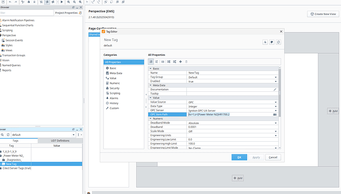

**Author:** ![uy\_huynh](https://avatars.discourse-cdn.com/v4/letter/u/54ee81/32.png) [@uy\_huynh](https://forum.inductiveautomation.com/u/uy_huynh)\
**Post date:** [July 16, 2025, 6:15am UTC](https://forum.inductiveautomation.com/t/power-meter-pm810/108529/3 "2025-07-16T06:15:40Z")
I didn't enable the zero based addressing option.
I just tried the 0.HR1700, but nothing shows up
 ![image](https://us1.discourse-cdn.com/inductiveautomation/original/3X/c/d/cd31be043b2156a85decf36e5f502b8afd415a48.png)

Can you try HRD (double) and or HRF (float)
The docs show a size 4 but the not the type other than mod10 which makes no sense.
Edit: mod10 should be a floating value
**Post date:** [July 16, 2025, 6:41am UTC](https://forum.inductiveautomation.com/t/power-meter-pm810/108529/6 "2025-07-16T06:41:27Z")
![image](https://us1.discourse-cdn.com/inductiveautomation/original/3X/9/2/9236899c76ff5464008b6f4b02789b9329a4d28d.png)

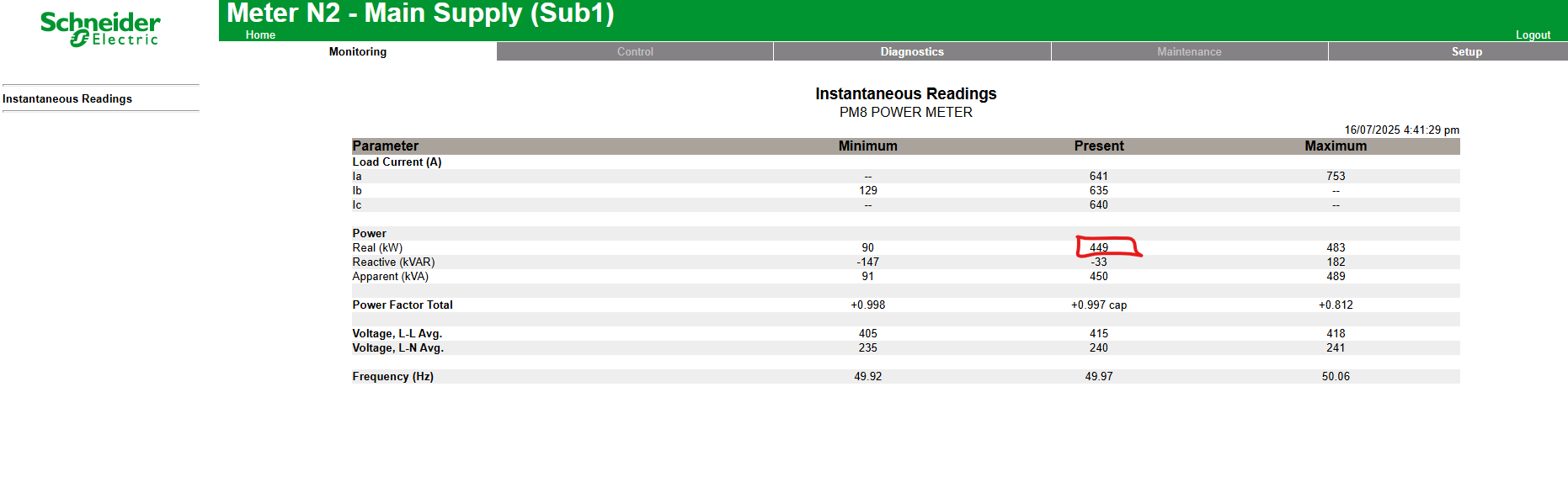

**Author:** ![Rick\_de\_Man](https://sea1.discourse-cdn.com/inductiveautomation/user_avatar/forum.inductiveautomation.com/rick_de_man/32/75670_2.png) [@Rick\_de\_Man](https://forum.inductiveautomation.com/u/Rick_de_Man)\
**Post date:** [July 16, 2025, 6:52am UTC](https://forum.inductiveautomation.com/t/power-meter-pm810/108529/7 "2025-07-16T06:52:13Z")
1700 is de energy input from like solar.
I think you where looking for 1708 energy Real Out.
Dont forget that the data type is WH from modbus, KW is showing in the dashboard.

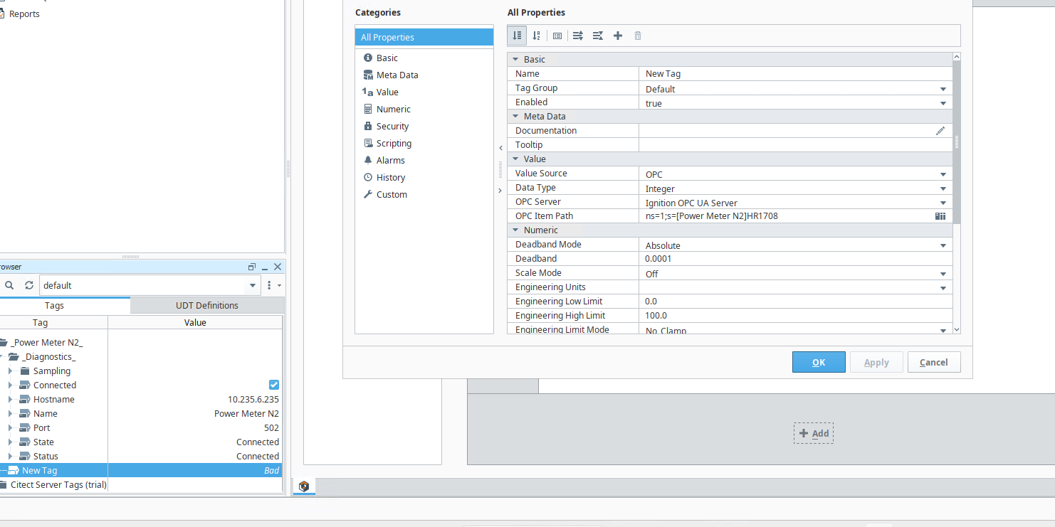

**Post date:** [July 16, 2025, 7:02am UTC](https://forum.inductiveautomation.com/t/power-meter-pm810/108529/8 "2025-07-16T07:02:40Z")
![image](https://us1.discourse-cdn.com/inductiveautomation/original/3X/1/6/16021ef44758f1021a358945f8af06908492da72.png)
Still no luck.

**Post date:** [July 16, 2025, 11:52am UTC](https://forum.inductiveautomation.com/t/power-meter-pm810/108529/13 "2025-07-16T11:52:20Z")
"mod10" is a Schneider-specific multi-word encoding for very large numbers. It is not supported by Ignition's native driver. You can bring in the individual words as separate tags and construct the composite with an expression tag.
This data type is directly supported by my alternate driver.

I actually have some pm800 series meters and had to figure this out. I read the 4 registers in a UDT and then created an expression tag to combine them.
```python
({[.]kWh_Reg4}*10000^3 + {[.]kWh_Reg3}*10000^2 + {[.]kWh_Reg2}*10000 + {[.]kWh_Reg1})/1000

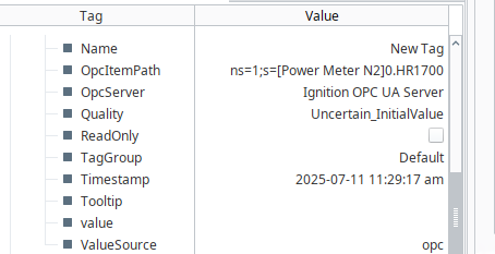

**Post date:** [July 17, 2025, 5:10am UTC](https://forum.inductiveautomation.com/t/power-meter-pm810/108529/16 "2025-07-17T05:10:15Z")
Thanks all
Apparently it should be 1.HR1700 , then 1701..1704. Then use josborn's xpresion to come up with total kwh.
