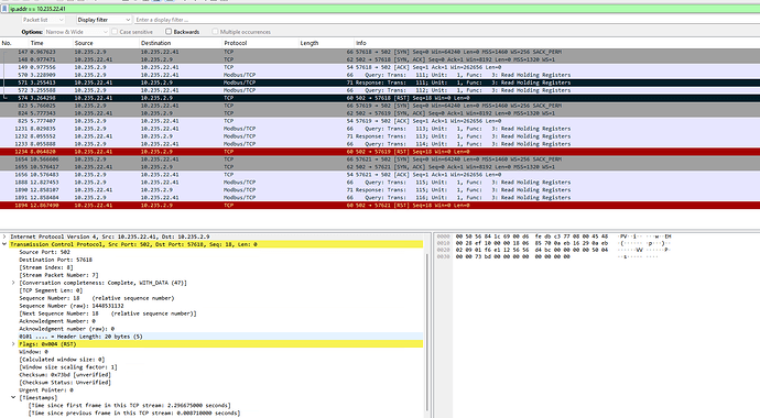

Alright so it happened again and I've found this on my wireshark. Any insight? Quite new to wireshark so I'm not 100% sure what it is saying here, but seem like something wrong so it triggered the rst flag
 ![image](https://us1.discourse-cdn.com/inductiveautomation/original/3X/d/3/d3c186d0c74838f8d15b07fca2a48660dff50fbb.png)
**Post date:** [July 29, 2025, 12:45am UTC](https://forum.inductiveautomation.com/t/power-meter-pm810/108529/32 "2025-07-29T00:45:43Z")
That's the device choking on the second request in each connection. You should drill into that request detail.
(That the device breaks the connection instead of returning an error code suggests that it is a piece of [expletive]. Not surprising, for Schneider.)
Side note: you should use a **capture** filter to avoid large PCAP file sizes, instead of a **display** filter. That would also make it practical to share the file, which will be necessary if you don't figure this out on your own.

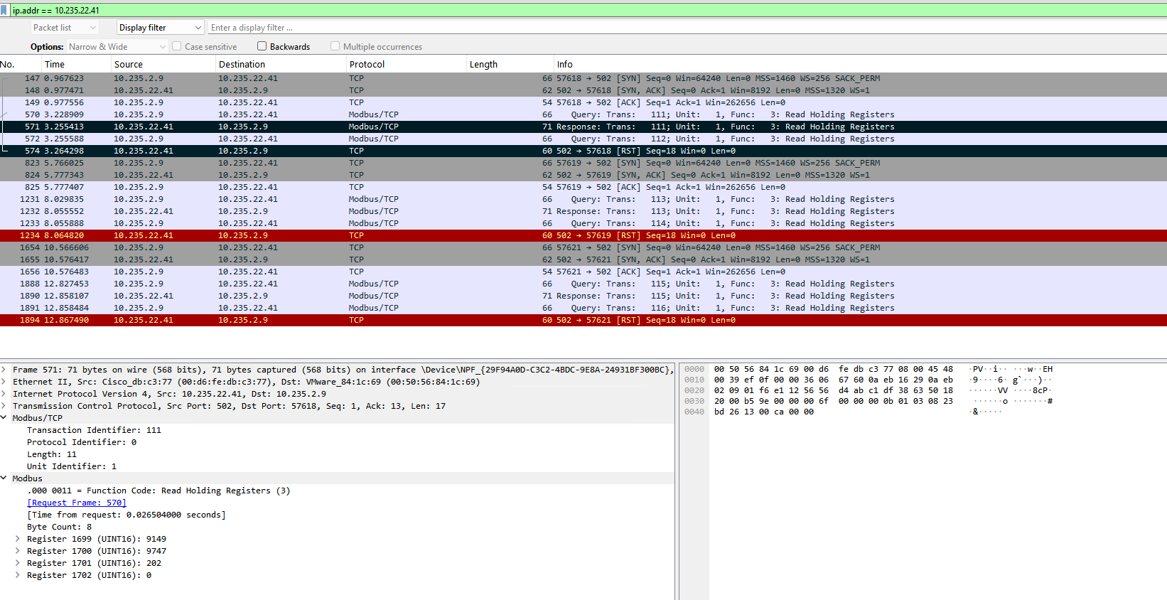

**Post date:** [July 29, 2025, 12:56am UTC](https://forum.inductiveautomation.com/t/power-meter-pm810/108529/34 "2025-07-29T00:56:00Z")
Pick one of the packets showing in the upper half of the wireshark window that shows a Modbus **Query** where the next packet is the RST instead of a Response. With the query packet selected, expand its protocol details in the bottom half of the window. Look at the function code and offset and quantity of that query.

I couldn't see the function code and etc in the RST.
But with the Response, it says .000 0011 function code. I think the RST is only TCP not MODBUS/TCP

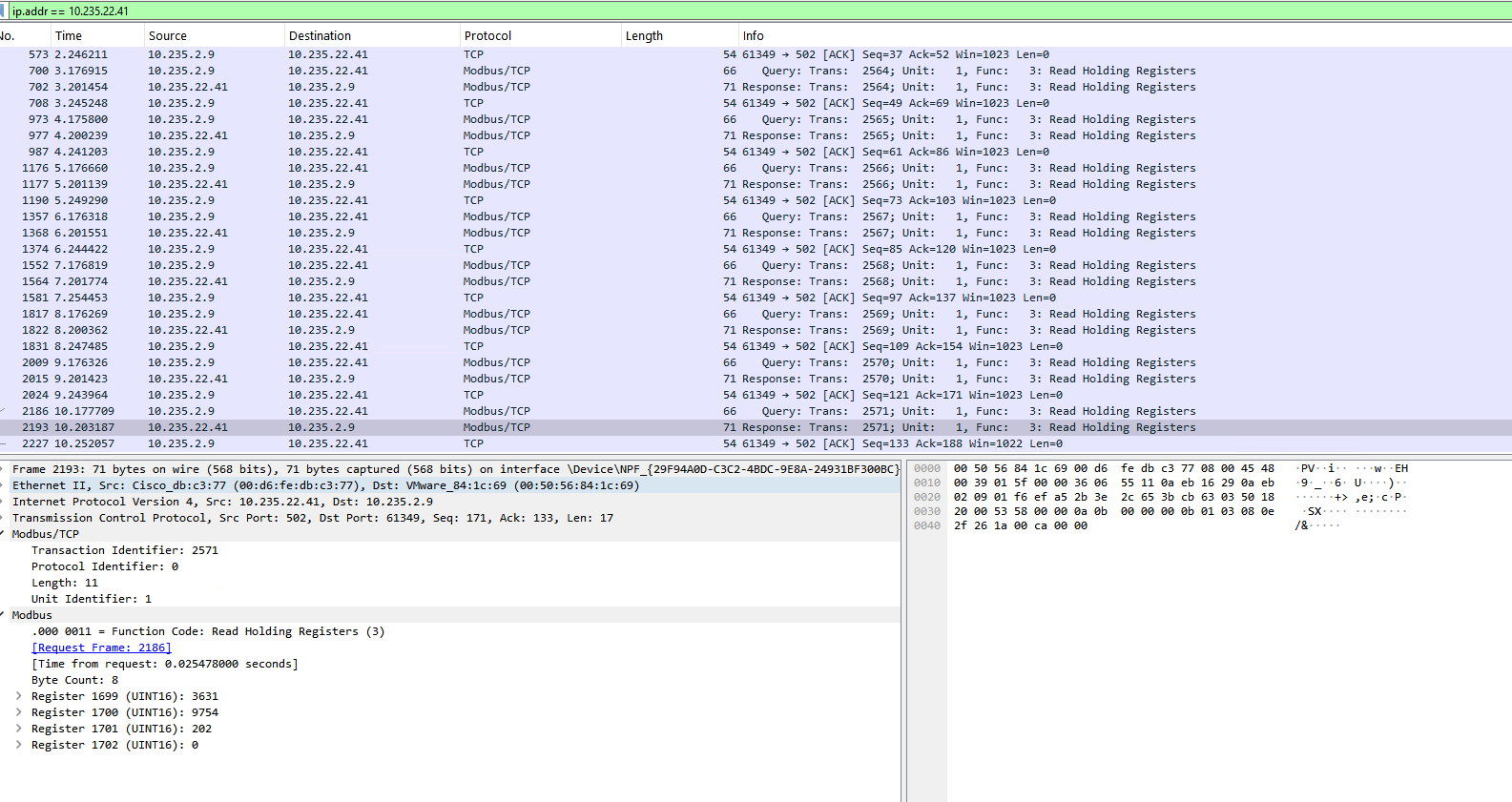

**Post date:** [July 29, 2025, 1:20am UTC](https://forum.inductiveautomation.com/t/power-meter-pm810/108529/36 "2025-07-29T01:20:13Z")
Following pic is after it became good 5 mins ago:
 ![image](https://us1.discourse-cdn.com/inductiveautomation/original/3X/1/3/1319a276e2f3920bdf599e1033fd2b3383541b75.png)

**Post date:** [July 29, 2025, 8:02am UTC](https://forum.inductiveautomation.com/t/power-meter-pm810/108529/37 "2025-07-29T08:02:37Z")
If I'm not mistaken, your screenshots that include the RST are:
1. Highlighting the Modbus response &
2. Highlighting the RST packet
Phil said,
> Pick one of the packets [...] that shows a Modbus **Query** where the next packet is the RST instead of a Response. With the query packet selected, expand its protocol details in the bottom half of the window. Look at the function code and offset and quantity of that query.
If I understand correctly, Phil is suggesting you take a look at the Modbus query/request that forces the Modbus device to reset the TCP connection. If you look at it, you may be able to figure out why the PLC is choking on this request.
Yes, `RST` is not a Modbus function, it's a TCP flag. It indicates the termination of the TCP connection. The same TCP connection you're sending/receiving Modbus with.
