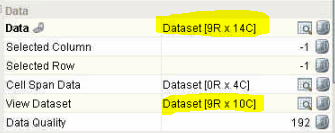

I have a few power tables in which the arrow keys and enter work completely fine on some columns to navigate cells, but on certain columns the focus/cursor is lost. Any ideas on what may be causing this? In the attached picture, it happens on column 'I'.
More Info:
- Using 7.9.4
- For the attached picture it happens to be the last column, but this is not necessarily the case on other power tables with the same issue
- I am using the OnCellEdited extension function to update data in a MSSQL table
- All columns have the same Table Properties
- Josh
 ![](https://us1.discourse-cdn.com/inductiveautomation/original/2X/7/7ae0ce54957ea3b892844030fe2e1372fc816d92.PNG)

Is probably the culprit - if the data "changes" out from underneath the current table model, it won't track your selection when the new data is rendered. You could try grabbing the current selection before running system.db.refresh, and then in a `system.util.invokeLater`-ed function, set the selection back to what it currently was.
**Author:** ![jlopez](https://avatars.discourse-cdn.com/v4/letter/j/aeb1de/32.png) [@jlopez](https://forum.inductiveautomation.com/u/jlopez)\
**Post date:** [January 22, 2019, 6:52pm UTC](https://forum.inductiveautomation.com/t/power-table-cells-in-certain-columns-lose-focus-cursor/21271/5 "2019-01-22T18:52:03Z")
You were correct! That was the culprit! Thanks a lot for the help. Below is my code in case any one else has trouble with this. Note that this code is in the `OnCellEdited()` extension function of the power table.
I added a conditional statement in the `system.util.invokeLater` function so that the cursor stays on the same cell if it is in the last row of the viewDataset. I also set polling to **OFF**
It was also important to realize that the power table’s dataset and view dataset differed in size. The dataset is 9 x 14 while the viewDataset (what is not hidden in the power table) is 9 x 10. For this reason, my code has the (col-1) in the change selection method of getTable().
 ![image](https://us1.discourse-cdn.com/inductiveautomation/original/2X/1/12dd62437c355e1fa82122f1f89fff8fe2757e26.png)
