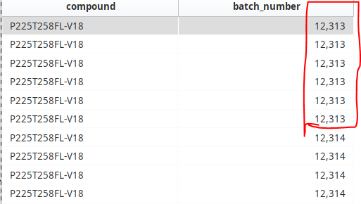

I am trying to format background color of the power table based on the value of previous column.
Here’s an example:
 ![image](https://us1.discourse-cdn.com/inductiveautomation/original/3X/7/6/76d8f86c8104b595b51e83df6aef7e1f7178fc27.png)
In the picture below, there are 6 rows with same column value of batch\_number hence, I want to have those rows grouped in same color and so on.
Here’s what I got but I think I am missing something:

**Author:** ![JGJohnson](https://sea1.discourse-cdn.com/inductiveautomation/user_avatar/forum.inductiveautomation.com/jgjohnson/32/29582_2.png) [@JGJohnson](https://forum.inductiveautomation.com/u/JGJohnson)\
**Post date:** [March 3, 2021, 11:48pm UTC](https://forum.inductiveautomation.com/t/power-table-color-grouping-based-on-1-cell-value/44037/2 "2021-03-03T23:48:19Z")
Here’s something I haven’t tested but should help. If your batch numbers skip around quite a bit you might end up having more than 1 consecutive group with the same color. If so then this script would need to be further refined.
```auto
rowColors = ["#EEEEEE", "#AAAAAA", "#777777"]
batch_number = self.data.getValueAt(rowIndex, "batch_number ")
return {"background": rowColors[batch_number % len(rowColors)] }
You can put as many colors in the rowColors list and the script will choose a color based on the modulus
**Author:** ![kaushik.shah](https://avatars.discourse-cdn.com/v4/letter/k/34f0e0/32.png) [@kaushik.shah](https://forum.inductiveautomation.com/u/kaushik.shah)\
**Post date:** [March 4, 2021, 11:03am UTC](https://forum.inductiveautomation.com/t/power-table-color-grouping-based-on-1-cell-value/44037/3 "2021-03-04T11:03:36Z")
@JGJohnson Thanks so much. That got me going.

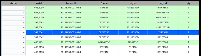

I’m looking at doing this as well. My following script works, but it sometimes gets messed up when I select a row
```auto
	rowColors = ['#CCFFCC', 'white']
	if colName == 'status':
		from javax.swing import JComboBox
		elements = [self.host,'Retrived','Not Found']
		dropdown = JComboBox(elements)
		dropdown.setSelectedItem(value)
		return {'renderer':dropdown}
	else:
		if colName == 'serial':
			serial = self.data.getValueAt(rowIndex,'serial')
			if rowIndex:
				prevSerial = self.data.getValueAt(rowIndex-1,'serial')
			else:
				self.toggle = 0
				prevSerial = serial
			if serial != prevSerial:
				self.toggle = not self.toggle
		if selected:
			return {'background': self.selectionBackground}
		else:
			return {'background': rowColors[self.toggle]}
Correct Rendering:
 ![image](https://us1.discourse-cdn.com/inductiveautomation/original/3X/0/9/09755a805afece226435b3a5c0865b083f3015c3.png)
Incorrect after selection:
 ![image](https://us1.discourse-cdn.com/inductiveautomation/original/3X/e/f/efcab8fa53a306de150ee28bfa4a1530388ad4ce.png)
**Author:** ![dkhayes117](https://sea1.discourse-cdn.com/inductiveautomation/user_avatar/forum.inductiveautomation.com/dkhayes117/32/68344_2.png) [@dkhayes117](https://forum.inductiveautomation.com/u/dkhayes117)\
**Post date:** [April 23, 2022, 6:05pm UTC](https://forum.inductiveautomation.com/t/power-table-color-grouping-based-on-1-cell-value/44037/5 "2022-04-23T18:05:13Z")
I found a way to make it faster and therefore the row selection does not mess up any more 🙂
First, I made a custom method on the table called `mapColors()`, it creates a list of unique values, serial numbers in my case, and keeps them in order according to how they appear in the table. I multiply my color list by the length of the set in order to make sure I have enough alternations to cover every serial number. The color mapping dictionary is then put in a client property.

Next, I call `mapColors()` anytime the data changes
```auto
if event.propertyName == 'data':
	event.source.mapColors()
Finally, `configureCell` call the color mapping client property and applies the correct color. I only call the colorMapping once when I’m in the ‘serial’ column and put it in another client property so I don’t have to get the serial number for every single cell in the row.
