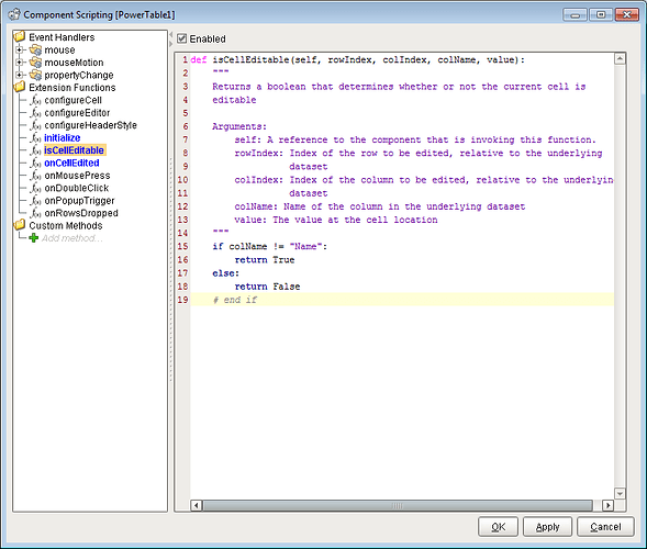

Is there a way to set a column to be editable through scripting? This is part of the custom properties of the power table, so I am skeptical…
If not, is there a third party table object I can use?
Thanks,
Chris Panici
**Author:** ![ethomason](https://sea1.discourse-cdn.com/inductiveautomation/user_avatar/forum.inductiveautomation.com/ethomason/32/43338_2.png) [@ethomason](https://forum.inductiveautomation.com/u/ethomason)\
**Post date:** [August 20, 2018, 6:18pm UTC](https://forum.inductiveautomation.com/t/power-table-column-editable-through-scripting/19331/2 "2018-08-20T18:18:55Z")
Yes, check colName and return True in the isCellEditable extension function
[https://support.inductiveautomation.com/index.php?/Knowledgebase/Article/View/109/2/working-with-power-table-extension-functions](https://support.inductiveautomation.com/index.php?/Knowledgebase/Article/View/109/2/working-with-power-table-extension-functions)
**Author:** ![christopher.panici](https://sea1.discourse-cdn.com/inductiveautomation/user_avatar/forum.inductiveautomation.com/christopher.panici/32/5814_2.png) [@christopher.panici](https://forum.inductiveautomation.com/u/christopher.panici)\
**Post date:** [August 20, 2018, 6:24pm UTC](https://forum.inductiveautomation.com/t/power-table-column-editable-through-scripting/19331/3 "2018-08-20T18:24:40Z")
![](https://us1.discourse-cdn.com/inductiveautomation/original/2X/3/3678142c06bc316369822f1e5657d5876552d8e1.png)

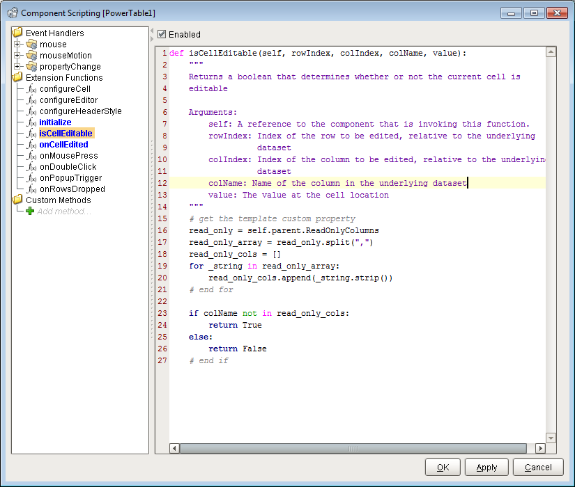

**Post date:** [August 20, 2018, 6:36pm UTC](https://forum.inductiveautomation.com/t/power-table-column-editable-through-scripting/19331/4 "2018-08-20T18:36:01Z")
Even making this a little more dynamic. I have a custom property called “ReadOnlyColumns” that I parse and if the selected column is not in this array it will return true.
 ![](https://us1.discourse-cdn.com/inductiveautomation/original/2X/e/ecc4f7476947fd6e7c9f14863ec2db417de02537.png)
