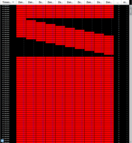

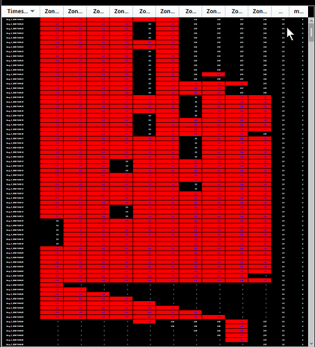

I have a power table that has an issue with the formatting. The table has a column with timestamps, 10 value columns, then 2 limit columns. The configure cell code (below) should reference the limit columns for the value columns. However, it will at times mark all of the value columns as being out of spec.
Something odd, that seems likely to be involved, the minimum and maximum "\<\>"s need to be reversed from what they should be to display properly when it is working.
Anecdotal observations:
- It shows up sometimes when the window is first started, other times it starts fine.
- It will sometimes show up after running fine for a while.
- It eventually seems to resolve on its own, for a while.
- I have at times been able to query times when it had happened and put that on the table and it showed up again. Other times I have tried and the table looked fine.
Here is the configureCell code, it’s loaded down trying to catch exceptions to figure out what is going on. I have not seen any exceptions with or without the error handling. It ‘thinks’ everything is working fine.

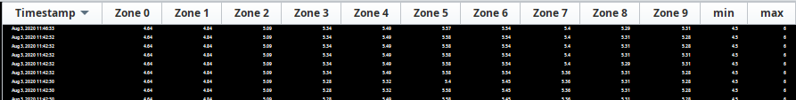

The columns when everything is within spec.
 ![Table Example 01](https://us1.discourse-cdn.com/inductiveautomation/original/3X/b/9/b91905d0751b6359722d6b9bb87f2f73dc5a68de.png)
The columns when something is out of spec.
 ![Table Example 03](https://us1.discourse-cdn.com/inductiveautomation/original/3X/5/2/527e888b47eea998393a8be40c3da0150819ea62.png)
The columns when things have been going wrong. This is from a video where the formatting is beginning to show properly, from the bottom, one row at a time every few seconds.
 ![Table Example 02](https://us1.discourse-cdn.com/inductiveautomation/original/3X/2/8/28b76d1225e8fd51404c27d63429956954ea13f6.png)
Screen captures of it today:
 ![20200803 - 1310 lam1 mahlo table osspec problem - crop](https://us1.discourse-cdn.com/inductiveautomation/original/3X/f/c/fcf3c500cfe72b284f77fa4212a613cb8c7ffe67.png)
 ![20200803 - 1505 lam1 mahlo table osspec problem - crop](https://us1.discourse-cdn.com/inductiveautomation/original/3X/d/e/de291d9daa299ef0f6d85df0cbf7edcfe40a864f.png)

This looks like a timing issue to me. The code being called while the data is updated, or something like that.
Are you using special scripts (perhaps with async code or separate threads) to load the data?
In any case, I would log (or just print) the timestamp, value, min and max of the red cells. Then you can see what values were found during the running of the script, and check if those are still the same in the table.
Note that the configureCell function doesn’t run on all cells, but only those in view. So if data gets loaded in a way that it doesn’t get registered, scrolling would indeed rerun the configureCell, and correct the mistakes on cells that come into view.

The dataset is generated using a script. It is then written to a dataset tag that the table’s data is bound to. I’ve added logging as you’ve suggested and I’ll update when I see what that tells me. Thanks for the advice.

The orange is the result of an exception - I would remove the exception clause and discover what conditions are causing the exception(s).
Another thought is to initialize the return dictionary at the beginning and set member values along the way then return the dictionary at the end. That will allow you to set background based on one condition, foreground on another condition etc. and you can expand formatting to include things like bold or italics as additional visual indicators on a cell.

The background color in the cells is red, with blue text (it does look orange in the photograph), the orange background with green text was so I could see if there was an error. It hasn’t ever shown up in production.
Adding to the dictionary as you’d mentioned sounds like a good way to go about things. Though, it doesn’t seem like it would change anything regarding the issue I’m having.
I did have the thought about the oddness with the reversed '\<\>'s. I’m going to try adding a condition to show if they have swapped back to normal during that time. Because that would make sense in at least some of the instances. (As much as boolean operators intermittently reversing meaning could make sense.)

Can you show that part of the script? And how the script is triggered?
**Author:** ![liam.mcglaughlin](https://avatars.discourse-cdn.com/v4/letter/l/a6a055/32.png) [@liam.mcglaughlin](https://forum.inductiveautomation.com/u/liam.mcglaughlin)\
**Post date:** [August 6, 2020, 1:03pm UTC](https://forum.inductiveautomation.com/t/power-table-configurecell-intermittently-returns-the-wrong-result-for-up-to-the-entire-table/37338/7 "2020-08-06T13:03:11Z")
The update\_mahlo\_ds() is called from a client timer script every 10s, fixed delay, shared. Takes ~115ms.
ptag is a convenience wrapper class. It uses readBlocking and writeBlocking system.tag functions.
