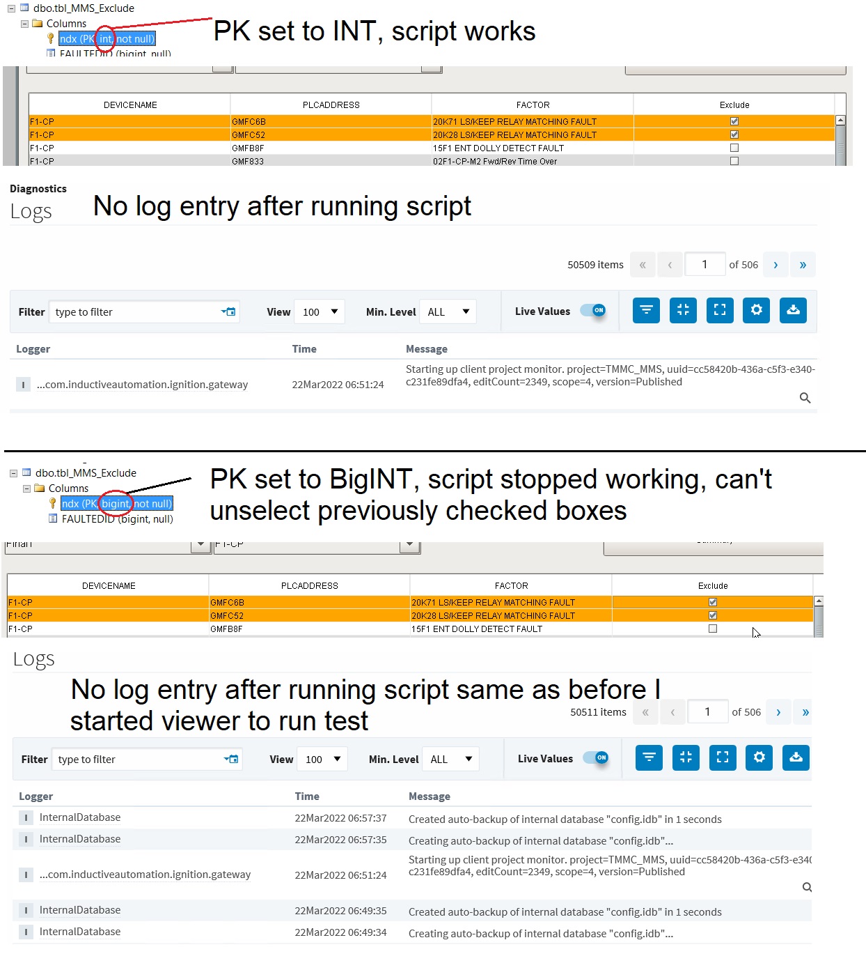

Hi, I have found that when the data type of a SQL Server 2014 PK column ‘ndx’ is set to INT, the power table scripts work fine but if I change the column to BIGINT, then the power table scripts do not work.
Is there a work around for this?

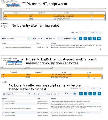

Hi, thank you for responding. I am using 7.9.12.
I ran a test just now and as soon as I changed the DB table PK to bigint, the script stopped working or at least the check boxes would no longer accept user input. They would change highlighted color but would not let me check/uncheck. Once I put the PK back to int, everything worked fine…
I could not see any obvious errors in the log (see attached pic).
![image](https://us1.discourse-cdn.com/inductiveautomation/original/3X/f/4/f454e7258ba46d8ec14ce1fb87a1c76483b3f456.png)
 ![int vs big int](https://us1.discourse-cdn.com/inductiveautomation/original/3X/3/6/3688d88d38fe71f90f7b2b7d4814601ac13d769b.jpeg)

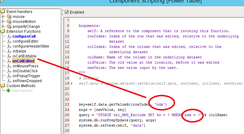

You might need to update your JDBC driver. Some versions didn’t handle java `BigInteger` to DB `bigint` properly. (Jython `long` is java `BigInteger`, not java `Long`.)
**Post date:** [March 22, 2022, 11:43am UTC](https://forum.inductiveautomation.com/t/power-table-oncelledited-sql-table-column-data-type-issue/57415/7 "2022-03-22T11:43:38Z")
To try what @bpreston is suggesting try changing `args = [newValue, key]` to `args = [newValue, long(key)]`

**Post date:** [March 22, 2022, 1:10pm UTC](https://forum.inductiveautomation.com/t/power-table-oncelledited-sql-table-column-data-type-issue/57415/10 "2022-03-22T13:10:51Z")
No, I’m suggesting changing your `onCellEdited` Extension function from:
```python
key = self.data.getValueAt(rowIndex, 'ndx')
args = [newValue,key]
query = 'UPDATE tbl_MMS_Exclued SET %s = ? WHERE ndx = ?' % (colName)
system.db.runPrepUpdate(query,args)
system.db.refresh(self,'data')
to something like:
```python
args = [newValue,long(key)]

I tried both 'long' and 'biginteger' but neither worked with the PK set to biginteger
 ![image](https://us1.discourse-cdn.com/inductiveautomation/original/3X/8/d/8d937d013cd380705fb7bd07a0dc35f6caa31635.png)
Thank you regardless
