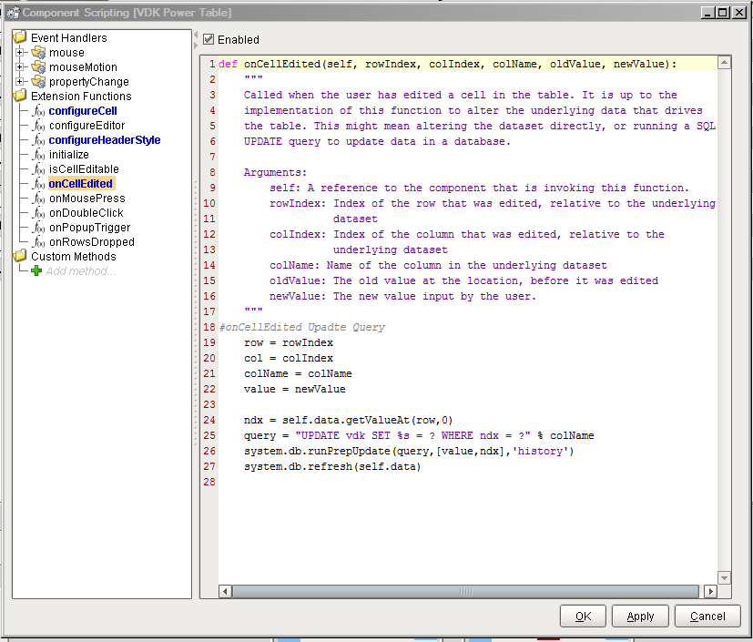

I am learning the differences between the standard Table Component and the Power Table Component… Slowly.
I am trying to update a dB table using the onCellEdited Extension Function and having no luck.
Please look at the scripting below and tell me what I have done wrong. (vdk is Table Name).
row = rowIndex
col = colIndex
colName = colName
value = newValue
ndx= self.data.getValueAt(row,0
query = “Update vdk SET %s = ? WHERE ndx = ?”
system.db.runPrepUpdate(query % colName, [value, ndx], ‘history’)

I think you're close.
First off correct this line by closing the parenthesis
The column name has to be added to the query string when it is defined, not inside the runPrepUpdate function.
> query = "Update vdk SET %s = ? WHERE ndx = ?" % colName
Fix those things and try again.

What have I neglected this time, Still nothing being written to dB. No errors either.
```auto
 row = rowIndex
 col = colIndex
 colName = colName
 value = newValue
 ndx = self.data.getValueAt(row,0)
 query = "UPDATE vdk SET %s = (?) WHERE ndx = (?)" %colName
 system.db.runPrepUpdate([value,ndx],'history')

The first parameter in runPrepUpdate has to be the query string.
If you update the line below all of your syntax should be correct, assuming that “history” is the name of your database.
`system.db.runPrepUpdate(query, [value,ndx],'history')`
[https://docs.inductiveautomation.com/display/DOC79/system.db.runPrepUpdate](https://docs.inductiveautomation.com/display/DOC79/system.db.runPrepUpdate)

Excellent. Thank you JGJohnson.
