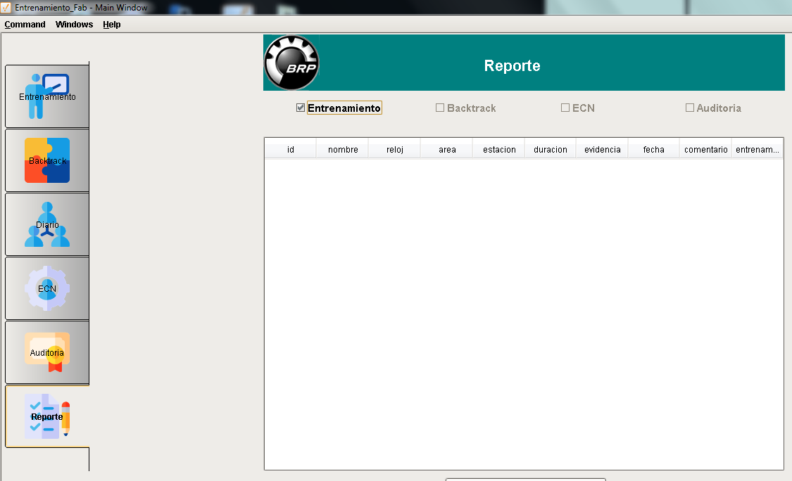

I have a power table showing information i get from a Query, When i’m on designer it shows the information properly like the following picture:
 ![image](https://us1.discourse-cdn.com/inductiveautomation/original/2X/7/75a16b401b507191fec1e5c2bd0777d1fc2491ab.png)
But when i run a client version on the same computer the information is gone.
 ![image](https://us1.discourse-cdn.com/inductiveautomation/original/2X/0/016645072d4ce77d17f8f2d1b3f85f351138aa68.png)
Do you have an idea of what could be happening?
Thanks in advance for the help.
Best regards.
**Post date:** [January 20, 2020, 2:49pm UTC](https://forum.inductiveautomation.com/t/power-table-query-info-not-appearing-in-client/31413/2 "2020-01-20T14:49:39Z")
Do you have legacy query permission turned on in the project’s security properties?
**Post date:** [January 20, 2020, 2:53pm UTC](https://forum.inductiveautomation.com/t/power-table-query-info-not-appearing-in-client/31413/3 "2020-01-20T14:53:22Z")
Consider converting your query to a named query so you can keep security tight.

Hello, thanks for the reply.
I have the following permissions:
