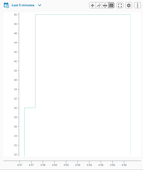

Hi everyone,
We would like to use the interpolation type “curveStepAfter” for our Powerchart. To achieve a true curveStepAfter visualization, we need to set the “pointCount” parameter to -1.
- D3’s curveStepAfter:
 ![image](https://us1.discourse-cdn.com/inductiveautomation/original/3X/a/8/a875ea3ee99418d6c966c822a15ef5312ce594e5.png)
- Graph with pointCount = 300:
 ![image](https://us1.discourse-cdn.com/inductiveautomation/original/3X/6/f/6f1a3fcccb1ac63c5beb01474b1d817d566eca55.png)
- Graph with pointCount = -1:
 ![image](https://us1.discourse-cdn.com/inductiveautomation/original/3X/9/6/965c02625968c3b50c13923ff914a45bdb34f840.png)
However, when we set pointCount = -1, we encounter performance issues when loading data over longer time periods, since all of that data needs to be loaded into the browser at once.
Is there a way to preserve the true curveStepAfter interpolation behavior while avoiding the limitations caused by loading large amounts of data?
Kind regards,
Stijn

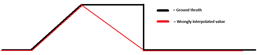

Most of our tags are Float. We have several tags that increase approximately linearly over time, but once they reach a certain value, they remain exactly at that value for about 2 hours. After the next OPC tag read, the value resets to its minimum. Since there are no tag value changes during this plateau, no new entries are written to the historian (which is the desired behavior), but this causes improper visualization with incorrect interpolation applied (e.g. not having the `pointCount = -1` and `pens[x].display.interpolation = curveStepAfter`). I've attempted to illustrate this below:
 ![image](https://us1.discourse-cdn.com/inductiveautomation/original/3X/9/2/923ad57f173fc5daedda66adaf9681654a23a149.png)

**Post date:** [November 6, 2025, 6:53pm UTC](https://forum.inductiveautomation.com/t/powerchart-interpolation-curvestepafter/112003/5 "2025-11-06T18:53:05Z")
> [@vtran](#):
> Alternatively, I think you can also change the Deadband Style to Discrete under the tag’s History config
This is the key.
> [@Power Chart Interpolation](https://forum.inductiveautomation.com/t/power-chart-interpolation/111041/9):
> I'm pretty sure the display.Interpolation property is applied to the displayed trend data after the points are aggregated and interpolated from the historian raw data to match the required point count. These trends are both incrementing second counters. The green has an analog deadband style and the orange is discrete. Other than that they are setup the same with a deadband of 5. The display.Interpolation is set to curveStepAfter. Setting the pointCount to a high number make the charts interpo…
> [@stijn.verhelst](#):
> We could experiment with this approach, although I understand it primarily affects the logic behind how values are recorded rather than how they're visualized in the Power Chart component.
This was my understanding too, but this is incorrect (see post attached)
