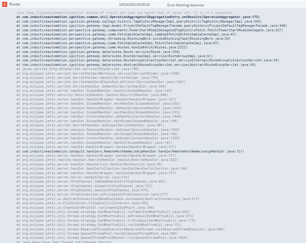

Hi Everyone-
I currently am historizing data via Canary. When I try to plot multiple lines on a powerchart. The lines do not show up and the following error is presented in the logs...
 ![image](https://us1.discourse-cdn.com/inductiveautomation/original/3X/2/e/2e547b7637f44ef1611464ccfe53669bce92e15f.png)
It appears to be an ignition error so maybe it is something someone has seen before?
Thanks!

I will be helpful to mention the versions involved of both Ignition and the Canary module.
There is a bug on where boolean values do not display with 8.1.28 and Canary Module 22.3.2. Don't know if it is fixed yet on newer modules.

Hi-
This would be using ignition 8.1.24 and canary module 22.2.0. This seems to be more of an issue with the aggregation process. I am able to plot 2 tags but when I add more than 2 is when I am getting the error listed above and my chart is blank.
