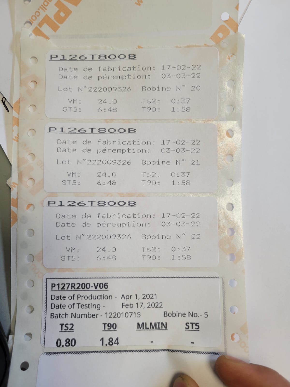

Hello There,
I’ve been trying this for a while before eventually coming here for expert advice.
We’ve a dot matrix printer Epson LQ-590. - [Epson LQ-590 - Epson](https://www.epson.eu/products/printers/dot-matrix-printers/epson-lq-590#accessories)
The need is to print number of labels (number provided by user). The paper used is 89 MM \* 36 MM. So, I designed a report for the same size with information needed. For now, I am testing with just trying to print 1 copy. The print does go through and it seems that its printing fine within a printable area. But, after printing the pointer moves certain index (skips 3 more papers) and stops at middle of the paper.
I am using following printer settings :

Its a result of trial and errors.
When I try putting,
```auto
job.setOrientation(1)
job.setPageHeight(1.41)
job.setPageWidth(3.5)
it prints something like this :
 ![WhatsApp Image 2022-02-18 at 12.40.47 PM](https://us1.discourse-cdn.com/inductiveautomation/original/3X/6/b/6bec2937c40e5642d2b4834648f0373ae04bb92c.jpeg)
The printer I am expecting is something like this :
 ![WhatsApp Image 2022-02-18 at 12.40.47 PM](https://us1.discourse-cdn.com/inductiveautomation/original/3X/2/6/26c54f87901ecfe14bca7f76ea83ef56f10dea10.jpeg)

I’m not super familiar but if the calculations work but seem off on printers usually it is a resolution issue throwing it off.
**Author:** ![Bryan\_Mason](https://sea1.discourse-cdn.com/inductiveautomation/user_avatar/forum.inductiveautomation.com/bryan_mason/32/30612_2.png) [@Bryan\_Mason](https://forum.inductiveautomation.com/u/Bryan_Mason)\
**Post date:** [February 18, 2022, 3:17pm UTC](https://forum.inductiveautomation.com/t/printing-labels-with-dot-matrix/56269/5 "2022-02-18T15:17:24Z")
What happens if you try a page height of 1 with top and bottom margins still set to 0?
