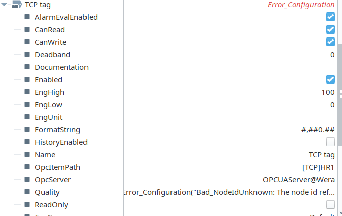

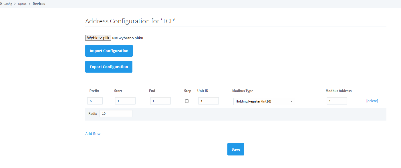

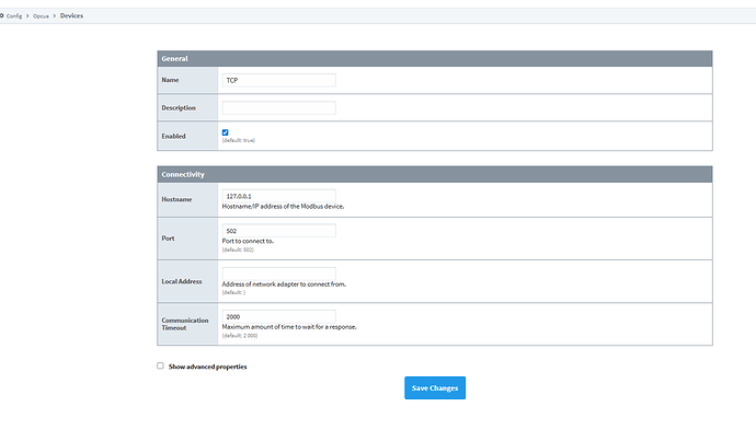

Hi everyone,
I’m trying to connect Ignition to a Modbus TCP slave simulator, but I can’t get it to work properly.
🔧 **What I’m doing:**
- Using **Ignition (non-commercial version)**
- Tried **two simulators** as Modbus slaves: Modbus Slave and ModRSsim2
- Both work fine with Modbus master tools like **Modbus Poll**
🔍 **My problem:**
- In Ignition, under **Devices** , my Modbus TCP device shows **“Connected”**
- But in **OPC Quick Client** , I **don’t see any tags or data**
- Logs show this error:
arduino
KopiujEdytuj
```python
java.io.IOException: End of stream reached.
at com.inductiveautomation.iosession.socket.AsyncSocketIOSession.run
💡 **What I’ve tried so far:**
- Turning firewall on/off
- Changing ports (502, 1502)
- Checking Unit IDs and register mapping
- Restarting Ignition and simulators
I followed this tutorial exactly but it still doesn’t work:
🔗 [YouTube – Ignition + Modbus TCP example](https://www.youtube.com/watch?v=Vh1s_nuKx6M&t=186s)
👉 **Has anyone had a similar issue with Ignition not reading data from a Modbus TCP simulator?**
Any ideas or tips would be greatly appreciated.
Thanks!

You added a Modbus device instance to Ignition's OPC UA server, but your tag seems to be addressing a Codesys OPC UA server?
What happened to your Ignition OPC UA loopback connection?

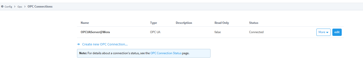

**Author:** ![wera.rum](https://avatars.discourse-cdn.com/v4/letter/w/edb3f5/32.png) [@wera.rum](https://forum.inductiveautomation.com/u/wera.rum)\
**Post date:** [July 15, 2025, 5:16pm UTC](https://forum.inductiveautomation.com/t/problem-connecting-ignition-to-modbus-tcp-slave-simulator-status-connected-but-no-data/108498/5 "2025-07-15T17:16:23Z")
Thank you for response.
 ![image](https://us1.discourse-cdn.com/inductiveautomation/original/3X/5/6/567e6eeb721090d88c97abf68b5907986e51fa2d.png)
Do you mean this server by Ignition's OPC UA server?
**Post date:** [July 15, 2025, 5:18pm UTC](https://forum.inductiveautomation.com/t/problem-connecting-ignition-to-modbus-tcp-slave-simulator-status-connected-but-no-data/108498/6 "2025-07-15T17:18:52Z")
You've made an external OPC connection to a CoDeSys device. For some reason, you didn't **add** that, but instead you **replaced** the loopback connection that Ignition has "out of the box".
You need to re-create ( **add** ) the loopback connection that Ignition installed with.

Do you mean that I should have the **Ignition OPC UA server** instead of the **Wera OPC UA server** (the external OPC connection to CODESYS)?
And that the **Wera OPC UA server** should appear in the hierarchy under the Ignition OPC UA server?
Is it possible to add this loopback connection without deleting the external OPC connection to CODESYS?
**Post date:** [July 15, 2025, 5:50pm UTC](https://forum.inductiveautomation.com/t/problem-connecting-ignition-to-modbus-tcp-slave-simulator-status-connected-but-no-data/108498/8 "2025-07-15T17:50:47Z")
1. Yes, your tags that connect to the modbus device need to use Ignition's OPC server, which you've disconnected from the rest of Ignition.
2. No, your external OPC **client** connection would be a **peer** to the loopback Ignition connection.
3. Yes, you can have many OPC **client** connections in Ignition to various OPC servers. It is expected that one of them will be a loopback connection to Ignition's own OPC server, and that is how Ignition installs. There's a link to **create** a new connection in your screenshot of your existing **client** connections.
( Consider doing a fresh install of Ignition into another system and inspect what that normal loopback connection has for properties. )
