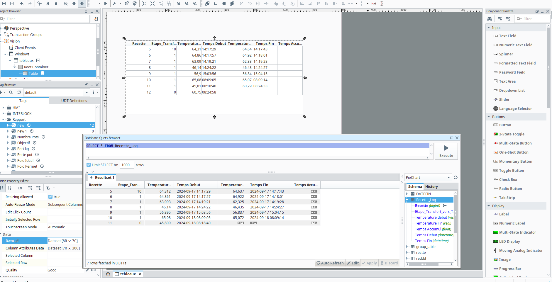

I created a database I managed to have it displayed on the designer in the form of a table but on the client the tables become red or even the attachments
 ![Capture d’écran 2024-09-18 083054](https://us1.discourse-cdn.com/inductiveautomation/original/3X/f/b/fb969b8bb0002b9040fe0da4ad27a4d3638d53ab.png)
 ![Capture d’écran 2024-09-18 083110](https://us1.discourse-cdn.com/inductiveautomation/original/3X/e/6/e64737f9aa6e11a1af44950ce8a4e9afb70840d6.png)
**Post date:** [September 18, 2024, 12:40pm UTC](https://forum.inductiveautomation.com/t/problem-on-the-client/96122/2 "2024-09-18T12:40:00Z")
Check your permissions in the project properties for vision in the designer. Database access is most likely disabled
**Author:** ![Koussaila\_Fekroune](https://avatars.discourse-cdn.com/v4/letter/k/96bed5/32.png) [@Koussaila\_Fekroune](https://forum.inductiveautomation.com/u/Koussaila_Fekroune)\
**Post date:** [September 18, 2024, 12:56pm UTC](https://forum.inductiveautomation.com/t/problem-on-the-client/96122/3 "2024-09-18T12:56:23Z")
how do I do it please
**Post date:** [September 18, 2024, 12:57pm UTC](https://forum.inductiveautomation.com/t/problem-on-the-client/96122/4 "2024-09-18T12:57:17Z")
