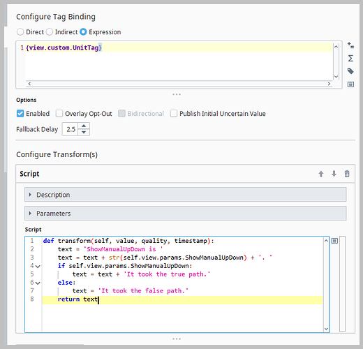

I have a simple script bound to the text of a label.
 ![image](https://us1.discourse-cdn.com/inductiveautomation/original/3X/4/1/41cd5bb125ddbcfc7bd81c3d555e85a3b90b413d.png)
This is the result that I am getting:
![image](https://us1.discourse-cdn.com/inductiveautomation/original/3X/6/4/6434056464dfef3f2f72437a031f25d5fbc63392.png)
**Author:** ![MMaynard](https://sea1.discourse-cdn.com/inductiveautomation/user_avatar/forum.inductiveautomation.com/mmaynard/32/3366_2.png) [@MMaynard](https://forum.inductiveautomation.com/u/MMaynard)\
**Post date:** [October 29, 2025, 3:35pm UTC](https://forum.inductiveautomation.com/t/problem-with-an-if-statement-in-a-script/111791/2 "2025-10-29T15:35:49Z")
What type of value is {self.view.params.ShowManualUpDown} ?
I would try to explicitly check the value of the param
if self.view.params.ShowManualUpDown==True:

**Author:** ![ryan.white](https://sea1.discourse-cdn.com/inductiveautomation/user_avatar/forum.inductiveautomation.com/ryan.white/32/73193_2.png) [@ryan.white](https://forum.inductiveautomation.com/u/ryan.white)\
**Post date:** [October 29, 2025, 3:47pm UTC](https://forum.inductiveautomation.com/t/problem-with-an-if-statement-in-a-script/111791/6 "2025-10-29T15:47:27Z")
Are you actually passing a boolean to the parameter? Perhaps a string is being passed and then coerced into a boolean during the check.
**Author:** ![Ryan\_Deardorff](https://sea1.discourse-cdn.com/inductiveautomation/user_avatar/forum.inductiveautomation.com/ryan_deardorff/32/63815_2.png) [@Ryan\_Deardorff](https://forum.inductiveautomation.com/u/Ryan_Deardorff)\
**Post date:** [October 29, 2025, 3:47pm UTC](https://forum.inductiveautomation.com/t/problem-with-an-if-statement-in-a-script/111791/7 "2025-10-29T15:47:28Z")
If ShowManualUpDown was an actual boolean, `str(ShowManualUpDown)` would be “False” not “false.” If it’s the string “false” then it would evaluate as True in a boolean expression.

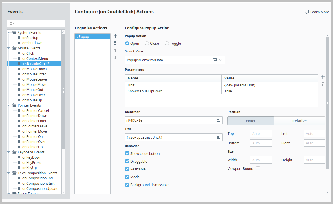

**Author:** ![steve.lankford](https://avatars.discourse-cdn.com/v4/letter/s/ecb155/32.png) [@steve.lankford](https://forum.inductiveautomation.com/u/steve.lankford)\
**Post date:** [October 29, 2025, 4:10pm UTC](https://forum.inductiveautomation.com/t/problem-with-an-if-statement-in-a-script/111791/8 "2025-10-29T16:10:25Z")
That’s the problem. It is being passed in as string and not a Boolean.
I am invoking it with:
 ![image](https://us1.discourse-cdn.com/inductiveautomation/original/3X/c/f/cf0cc0868fbfa5eeeb221eb4427f3ab6e5d68049.png)
That is passing it as a string.
Thank you everyone for your help and suggestions on this.
