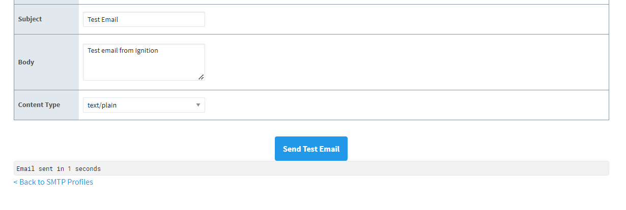

I have a problem with email notifications in ignition.
I have email settings -\> SMTP Profile created and its work fine. I can send a test email.
 ![image](https://us1.discourse-cdn.com/inductiveautomation/original/3X/f/a/fafb181b038dc1a87cb4864d1d3ef411b3145fce.png)
 ![image](https://us1.discourse-cdn.com/inductiveautomation/original/3X/6/1/616a341abc5f4fb326aeda2082a5c4dd6832acff.png)

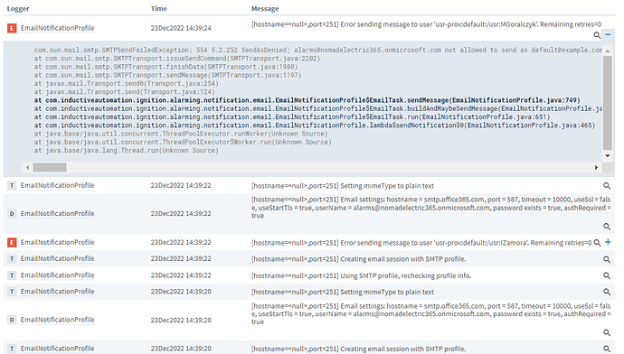

Unfortunately, this configuration does not want to save I also performed a restart of the gateway without success. Internally it tries to connect after the lower defined mailbox outside SMTP profiles? What went wrong?
Below logs when sending email shows undefined SMTP profile:
 ![image](https://us1.discourse-cdn.com/inductiveautomation/original/3X/d/c/dc6d5a8fdc6d3c85eca57114856759a3669a6a5e.png)
 ![image](https://us1.discourse-cdn.com/inductiveautomation/original/3X/8/2/8210bc3f06f35bc52c6a1bf7d674e0cafecc88f2.png)

Can you set that EmailNotificationProfile logger to TRACE and try your test again?

Set to TRACE:

**Post date:** [December 23, 2022, 1:35pm UTC](https://forum.inductiveautomation.com/t/problem-with-email-notifications/67924/4 "2022-12-23T13:35:18Z")
Click the "+" icon on those errors to get the complete message.

```auto
com.sun.mail.smtp.SMTPSendFailedException: 554 5.2.252 SendAsDenied; alarms@nomadelectric365.onmicrosoft.com not allowed to send as default@example.com; STOREDRV.Submission.Exception:SendAsDeniedException.MapiExceptionSendAsDenied; Failed to process message due to a permanent exception with message [BeginDiagnosticData]Cannot submit message. 0.35250:96320000, 1.36674:01000000, 1.61250:00000000, 1.45378:02000000, 1.44866:00000000, 1.36674:7A000000, 1.61250:00000000, 1.45378:05000000, 1.44866:00140000, 1.36674:0A000000, 1.61250:00000000, 1.45378:16000000, 1.44866:A01B0000, 1.36674:0E000000, 1.61250:00000000, 1.45378:B91B0000, 1.44866:36020000, 16.55847:D70E0000, 17.43559:0000000030020000000000000000000000000000, 20.52176:140F38970D00101019000000, 20.50032:140F38977D17000090330000, 0.53414:32000000, 0.35180:03000136, 255.23226:95330000, 255.27962:7A000000, 255.27962:0A000000, 255.27962:0E000000, 255.31418:4A000000, 0.35250:4800D13D, 1.36674:0A000000, 1.61250:00000000, 1.45378:02000000, 1.44866:52000000, 1.36674:32000000, 1.61250:00000000, 1.45378:57000000, 1.44866:01000000, 16.55847:CD000000, 17.43559:00000000D0030000000000000000000000000000, 20.52176:140F38970D0010106F000000, 20.50032:140F38977D170000B8330000, 0.53414:74000000, 0.35180:0A004366, 255.23226:BD330000, 255.27962:0A000000, 255.27962:32000000, 255.17082:DC040000, 0.27745:7E000000, 4.21921:DC040000, 255.27962:FA000000, 255.1494:81000000, 0.38698:46000000, 1.41134:46000000, 0.37692:86000000, 0.37948:86000000, 5.33852:00000000534D545000000000, 7.36354:010000000000010986000000, 4.56248:DC040000, 7.40748:010000000000010B5A000100, 7.57132:00000000000000005A000100, 4.39640:DC040000, 1.63016:32000000, 8.45434:801084DC5D77764E9966D22C1E38B3B75A000100, 1.46798:04000000, 5.10786:0000000031352E32302E353934342E3031333A444237505230374D42363130383A35303630366537362D663734362D346135662D393333662D3238393835396231336563393A3131343239363A2E4E4554204672616D65776F726B20342E382E393033322E30001000000000, 7.51330:4416CC1AEBE4DA0800000000, 0.39570:07000000, 1.55954:0A000000, 0.49266:02000000, 1.33010:0A000000, 2.54258:00000000, 0.40002:7A000000, 1.56562:00000000, 1.33010:0A000000, 2.54258:00000000, 0.40002:7A000000, 1.56562:00000000, 1.64146:32000000, 1.33010:32000000, 2.54258:DC040000, 1.33010:32000000, 2.54258:DC040000, 255.1750:0B00F410, 255.31418:07360000, 0.22753:DC000000, 255.21817:DC040000, 0.64418:0C360000, 4.39842:DC040000, 0.41586:02019866, 4.60547:DC040000, 0.21966:E3000000, 4.30158:DC040000[EndDiagnosticData] [Hostname=DB7PR07MB6108.eurprd07.prod.outlook.com]

**Post date:** [December 23, 2022, 1:44pm UTC](https://forum.inductiveautomation.com/t/problem-with-email-notifications/67924/6 "2022-12-23T13:44:40Z")
Somewhere you are missing **your** from address. It needs to be a valid "from" address for that email account.

**Post date:** [December 23, 2022, 1:49pm UTC](https://forum.inductiveautomation.com/t/problem-with-email-notifications/67924/7 "2022-12-23T13:49:43Z")
Somehow it cleared up when changing the mailbox domain, thank you!
