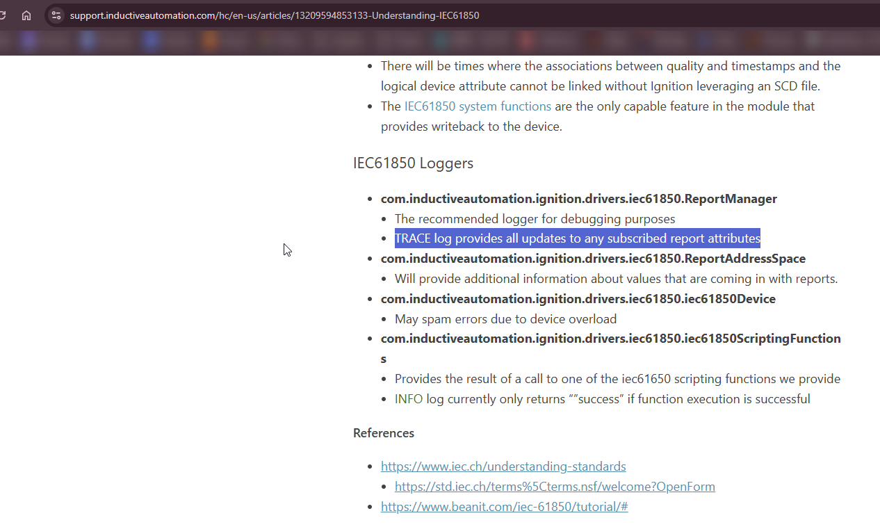

Did you have any success with this @Diego_Mejia ? Can confirm the trace error is built into the IEC 61850 client driver.
 ![image](https://us1.discourse-cdn.com/inductiveautomation/original/3X/3/1/31bdb941c85da9acbb5ec1d81232b3378779fbd5.png)
 ![image](https://us1.discourse-cdn.com/inductiveautomation/original/3X/b/0/b0759331d61e737a0289ed4b108f9b3cae276ad2.png)
[https://support.inductiveautomation.com/hc/en-us/articles/13209594853133-Understanding-IEC61850](https://support.inductiveautomation.com/hc/en-us/articles/13209594853133-Understanding-IEC61850)
**Post date:** [July 31, 2025, 11:12pm UTC](https://forum.inductiveautomation.com/t/problem-with-iec61850/101650/6 "2025-07-31T23:12:19Z")
This is "trace" logging at error severity coming from the underlying 61850 library we use.
You might need to open a support ticket and provide your logs and possibly a Wireshark capture - I don't know what this means and will probably have to go to the library vendor to get support.
At face value it's saying there was an error decoding a value... not sure if it's something that exists in the server but no in the client, or vice-versa... really not sure what it means.
