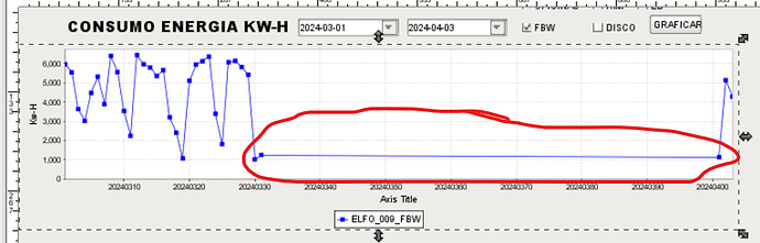

Hello
how can reduce the range of X, now the range of the 00 at 90 and only I need of 00 at 40

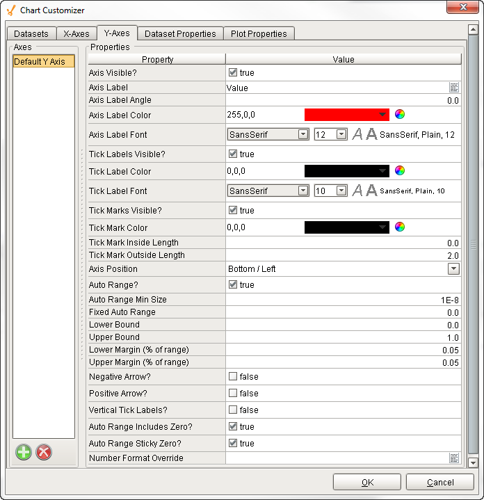

Specify a different "Lower Bound" in the Chart Customizer:
 ![image](https://us1.discourse-cdn.com/inductiveautomation/original/3X/3/b/3b68cef16d5b39d34cab8bd24f51bcf7fe9ad5fa.png)
> **[Vision - Chart Customizer | Ignition User Manual](https://www.docs.inductiveautomation.com/docs/8.1/appendix/components/vision-components/charts/chart/chart-customizer#y-axes-tab)**
> The Chart component, also known as the Classic Chart, can be used to make almost any kind of chart. It provides a flexible way to display XY charts using a host of built-in properties. All you need to do to create a chart is add datasets, fill them...

but in my case is in X-Axes
 ![image](https://us1.discourse-cdn.com/inductiveautomation/original/3X/9/6/964abe0aa789a134ccdf24996febae3ca8fca558.png)
I used Int
