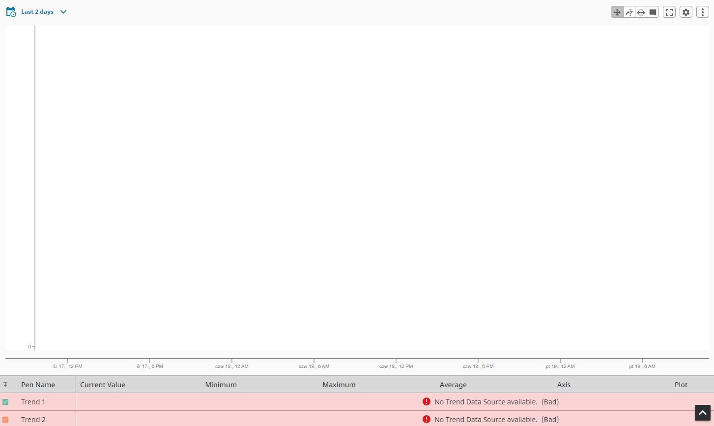

Hello,
I have a question about the trend in the Power Chart because it abnormal behaves on my Perspective Client.
When I have a large range set, the trend throws the error "No Trend Data Source available (Bad)" when I reduce it a little I have a line connecting between two points. When I give a small range the last few hours the graph comes back to display correctly. What is the reason for this?
1:
 ![image](https://us1.discourse-cdn.com/inductiveautomation/original/3X/d/c/dc4eac8ccaa37b1948c9acb2abeddffae2554eff.png)
2:
 ![image](https://us1.discourse-cdn.com/inductiveautomation/original/3X/4/e/4ed15928630df1ba54dbc5480222758f2b22431f.png)
3:
 ![image](https://us1.discourse-cdn.com/inductiveautomation/original/3X/7/0/702ce9a713d060ba18f189108703c22992256eb0.png)
Regards
Michał
**Post date:** [April 19, 2024, 10:43am UTC](https://forum.inductiveautomation.com/t/problem-with-power-chart-incorrect-trend-behaviour-in-the-chart/89098/2 "2024-04-19T10:43:49Z")
I would think your database query for the large time frame is timing out. You may need a faster database. There are probably messages in your gateway log corresponding to these attempts.
