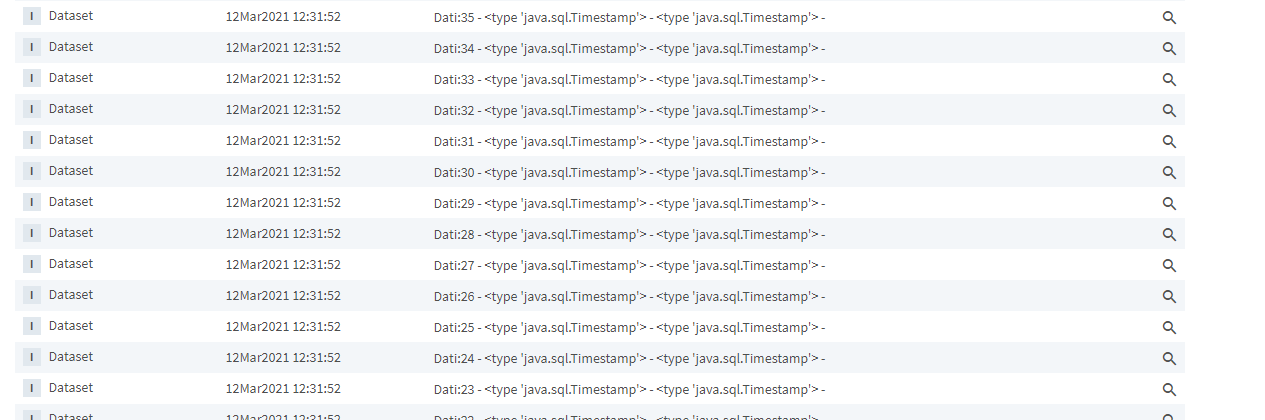

**Author:** ![fabio.gambarin](https://sea1.discourse-cdn.com/inductiveautomation/user_avatar/forum.inductiveautomation.com/fabio.gambarin/32/20449_2.png) [@fabio.gambarin](https://forum.inductiveautomation.com/u/fabio.gambarin)\
**Post date:** [March 12, 2021, 12:52pm UTC](https://forum.inductiveautomation.com/t/problem-with-timestamp/44309/9 "2021-03-12T12:52:11Z")
I converted as jordan suggested
eventStop=Timestamp(endTime.getTime())
actually I’m facing a stange behaviour,now the code is executing.
If I look at the dataset when I’m using perspective i get all field formatted as java.sql.Timestamp
 ![image](https://us1.discourse-cdn.com/inductiveautomation/original/3X/4/5/45f7f8c15e7be6b5a2a6e6bc80ed8d5696abdcfa.png)
If I use the script console I got the problem:
 ![image](https://us1.discourse-cdn.com/inductiveautomation/original/3X/c/b/cb20491e7b0d08c82d25fcdb545b16163c74e149.png)
This looks very strange
