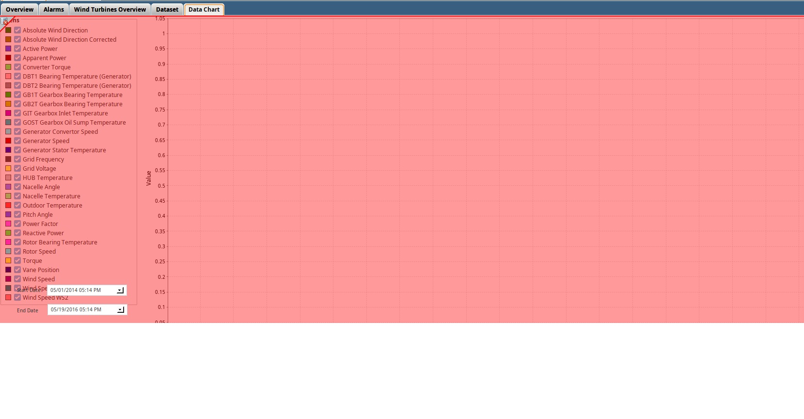

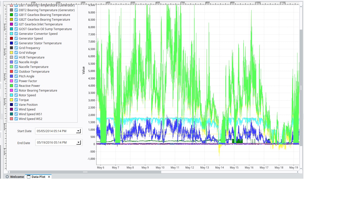

Good morning everyone,
Hoping somebody could point me in the right direction.
I am using an easy chart to display historical data stored in a database. My database connection is valid and I can see the data plotted in the designer, however, when I launch my project there is a big red box on top of my chart and I am not able to visualize any data in the chart. Judging by the icon next to the database icon, there is a problem with the connection but I am not sure where to look.
Here are some images attached. Thanks everyone!
Here’s my easy chart in the designer.

Here’s my easy chart when I launch the project:
 ![data_2](https://us1.discourse-cdn.com/inductiveautomation/original/2X/2/25ed41c81a00365f7073bde005a9fdf20ae36c61.jpeg)

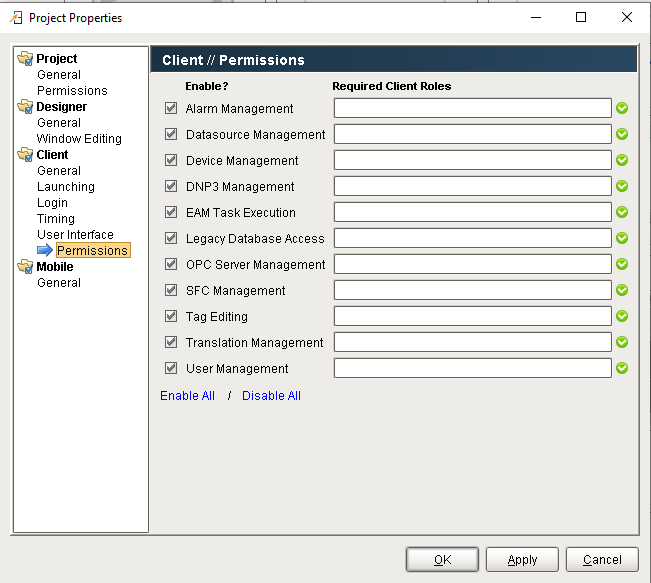

Have you checked the client permissions on your project properties?
 ![image](https://us1.discourse-cdn.com/inductiveautomation/original/2X/9/90747d7dfe0f28a484a8c8d565331ae41b11a330.png)
**Author:** ![fbrinneman](https://avatars.discourse-cdn.com/v4/letter/f/e9a140/32.png) [@fbrinneman](https://forum.inductiveautomation.com/u/fbrinneman)\
**Post date:** [May 27, 2020, 1:16pm UTC](https://forum.inductiveautomation.com/t/problems-displaying-historical-data-from-a-database/35076/3 "2020-05-27T13:16:07Z")
Thank you William!
That fixed my problem. Awesome!
