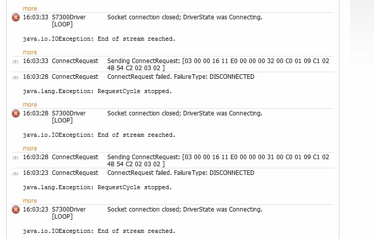

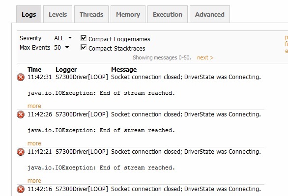

Hi,
I am trying connect the OPC UA Server with a S7 300.
Now this PLC is connected with an Kepware OPC DA Server in another Server. I have tried to disconnect this Da Server but the connection goes on “Disconnect”
I can´t connect with it and I get in the log the message that show the figure below
S7 driver Version → 1.5.0
Gateway version → 7.5.7
Thanks

It might help to go to the levels tab, search for the ConnectRequest, find the one associated with your device, and turn that to TRACE.
Without seeing any logs my guess is that you have an incorrect rack, slot, or PDU size configured.

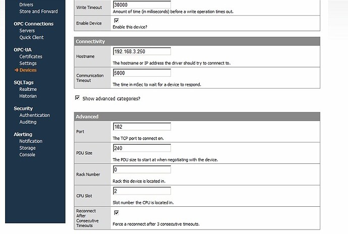

I´ve copied the configuration of kepware.
Now I´ve installed a demo version of kepware and I can comunicate with the S7.
In relation of PDU size, how I could know this one? In kepware doesn´t appear this parameter.
I´ve upload the kepware configuration and the S7 driver configuration.
Thanks

Dang. You happen to know how to use Wireshark? If not you can call into support and they can help walk you through it…
What’s happening is that the PLC is closing the connection after receiving the connect request from Ignition’s Siemens driver. There’s no indication why, but generally it indicates that it doesn’t like something about it, which is why my first guess was the rack or slot number being incorrect.
If you could capture the network traffic between Kepware and the PLC I could probably figure out what the difference is and what part of the connect request Ignition sends that the PLC is objecting to…
