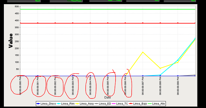

Hello
I do a chart but I have a problen whit the X Axis, in my Dataset Table I see the data ok but in the chart in the X axis is diferent
example
in my dataset from 0 to 10 but in the X axis from 6:00:00:000 to 6:00:00:010 , I don’t know whit put the 6:00:00
 ![image](https://us1.discourse-cdn.com/inductiveautomation/original/3X/f/3/f31e9636a07d2955e48900bfd5633fd625379156.png)
 ![image](https://us1.discourse-cdn.com/inductiveautomation/original/3X/9/2/9289a9102c93916fec855e2a457c131f29d91ded.png)
**Author:** ![kaushik.shah](https://avatars.discourse-cdn.com/v4/letter/k/34f0e0/32.png) [@kaushik.shah](https://forum.inductiveautomation.com/u/kaushik.shah)\
**Post date:** [June 23, 2020, 3:36pm UTC](https://forum.inductiveautomation.com/t/problen-whit-chart-x-axis/35921/2 "2020-06-23T15:36:55Z")
I think it is probably a Date Axis which what it is set to as default when you get new chart component !
Try adding new number axis as below,
 ![image](https://us1.discourse-cdn.com/inductiveautomation/original/3X/9/b/9b55a2e62504f9031b5626d3ab07ffb94dffc10d.png)
and change the dataset property to reference your new number axis.
 ![image](https://us1.discourse-cdn.com/inductiveautomation/original/3X/2/7/274b835105cb312253a7da452c176b76962182bb.png)
