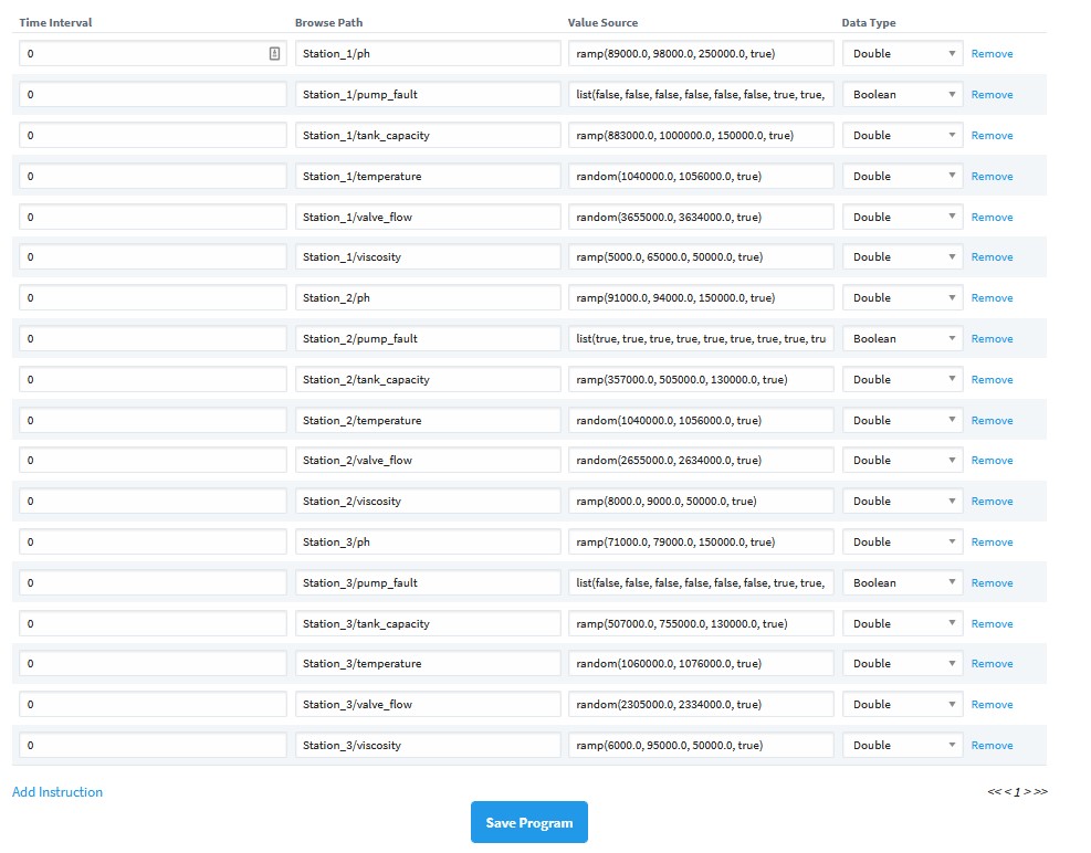

I’m creating the Building in Persepctive project from the new Inductive University course and to simulate the values in the project it is used a Programmable Device Simulator imported with a csv file.
I’m encountering a problem when creating the simulator: after I save the configuration the simulated values get modified and get multiplied by 10, in this way I can’t get the values I wanted for the corresponding quantities
 ![Immagine 2021-08-06 120932](https://us1.discourse-cdn.com/inductiveautomation/original/3X/3/1/31795d3d4643f5fcfb13ba92aa0448f6e28e1bcb.jpeg)
 ![Immagine 2021-08-06 120948](https://us1.discourse-cdn.com/inductiveautomation/original/3X/b/7/b7598dd86ea378e081d69f4fa6e81f46046d7286.jpeg)

ive had it too, its a bugg from igntion and has something to do with your locale. this worked for me:
> [@\[Bug-2323\] number conversion Gateway locale(?)](https://forum.inductiveautomation.com/t/bug-2323-number-conversion-gateway-locale/45750/7):
> So changing the locale (or the date formatting in the current locale) will only change the behavior of being able to make saving the simulator program work in a reliable manner. In the following screen recording, you will see the following: Initially my Windows system is configured to start an Ignition service as my user tester that is setup for a French locale, with French data formatting. I display the simulator program in this context on the server itself and on my local system which has E…
If its just for a test, its realy not that worth it changing it tbh...
By removing the acces zeros and the .0 you will be able to save it for the right value atleast once.
