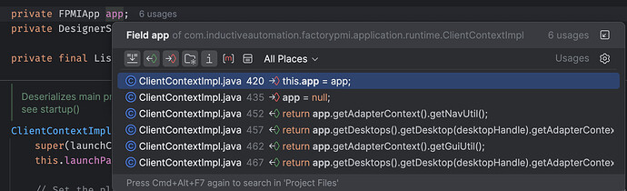

It's been deprecated since (at least) 2011. As the person who would be in charge of ever dealing with removing it...it's not ever going to get removed.
There's no way to get the private `app` field from the `ClientContextImpl` you get delivered on startup:
 ![image](https://us1.discourse-cdn.com/inductiveautomation/original/3X/c/f/cf413fd948b5115c21c1eb99bb083caa9906b58c.jpeg)
